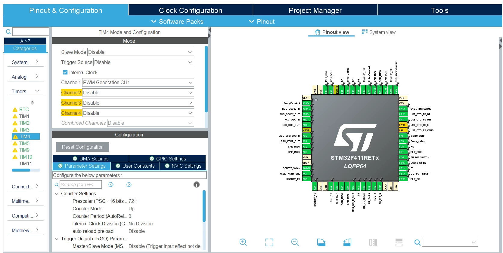

I am using the STM32F411 MCU and i am trying to generate PWM signal with fixed dutycycle and frequency.

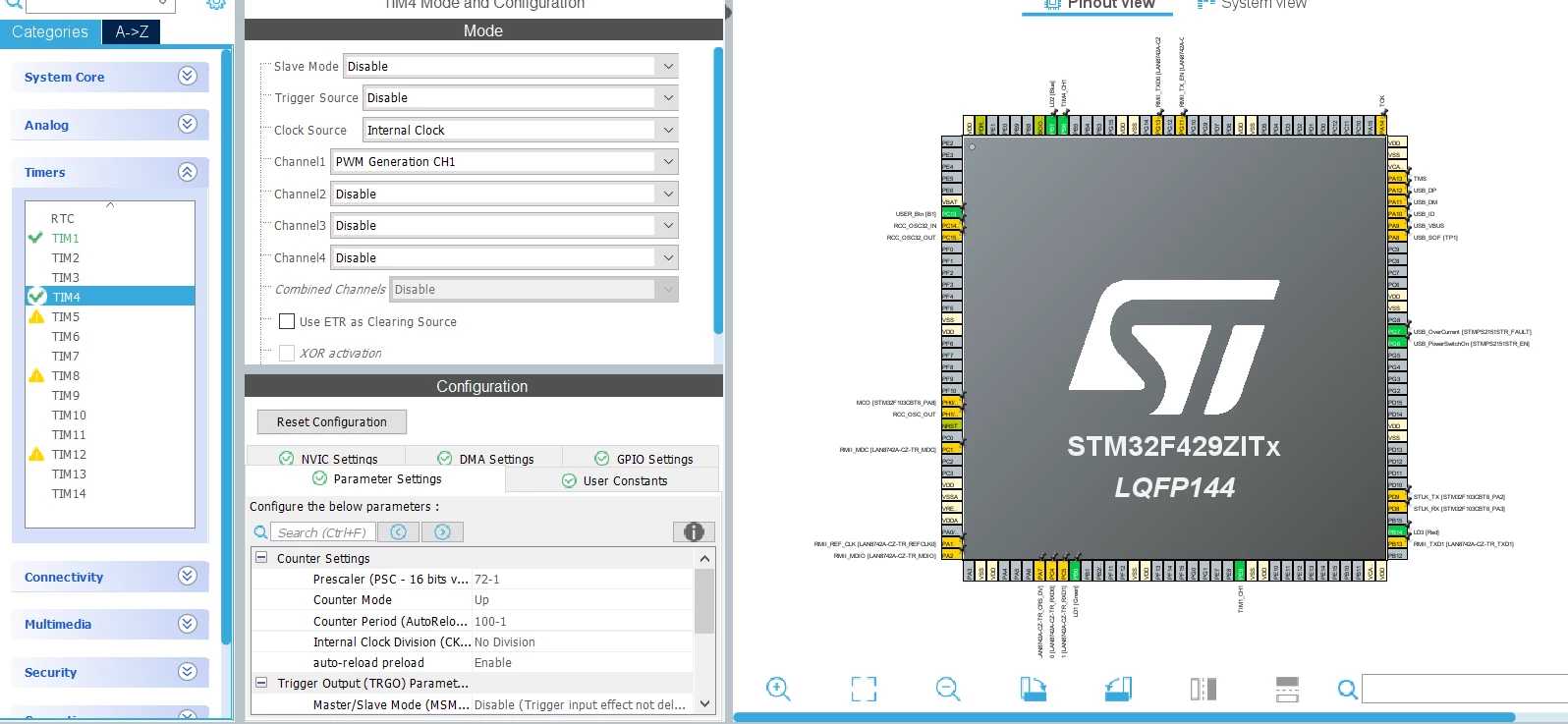

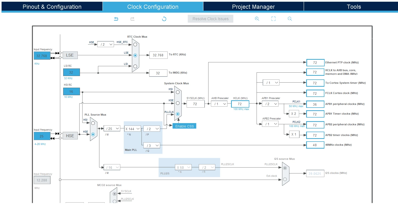

clock configuration and timer settings is attached below.
When I set the PWM frequency to 10KHz and the duty cycle to 50%, I get the output as 10 KHz frequency and the dutycycle toggles between 50.00% and 49.97%. When setting PWM frequency to 40KHz and duty cycle to 50%, I get output as 40 KHz frequency and dutycycle toggles between 48.00% and 47.97%.

I would check the clock source, but since you're using HSE, I don't think that would be the problem
Try to get the prescaler to zero, and do all the division in the period

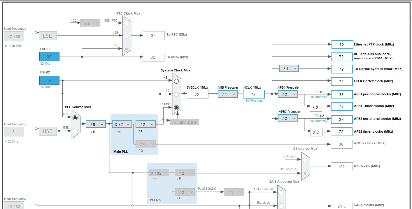

vrindarAuthor
Mar 1, 2024 4:26 AM UTC
Hello @Sarra.S
I tried the same in the Evaluation board(STM32F429ZI) using HSI but got the same variation in the duty cycle.
