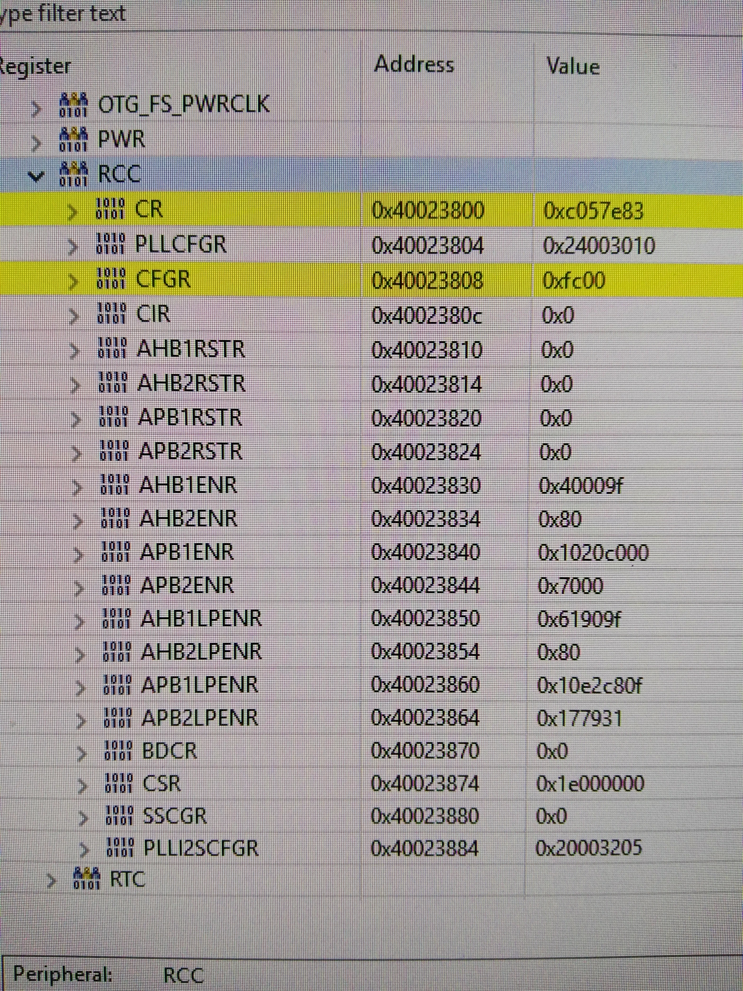

Hello!
I have problem with spi4 clock speed. I want to drive a lcd tft display but spi clock is max 500Khz, baudrate prescaler set to SPI_BAUDRATEPRESCALER_2. Is very weird. Initial setup was made with CubeMX to 48Mbit/s. APB2 clock is set to 96Mhz. I tried with dma, and without hal but the speed remains the same
What is the cause of this very low spi clock output speed?

As you can see, although PLL is switched on in CR, PLLCFGR is at its default value; nonetheless your system clock is set to HSI in CFGR, and both APB dividers are set to 16 (maximum).
In other words, you don't run the SystemClock_Config() function as you've presented us above. Find out, how do you actually set the clocks.

waclawek.jan
Jul 20, 2019 9:06 AM UTC
And you know that how?

waclawek.jan
Jul 20, 2019 9:53 AM UTC
And what's the actual SPI clock, as measured on the SCK pin?
waclawek.jan
Jul 20, 2019 9:55 AM UTC
Read out and check/post the relevant RCC register's content.
Do you use any bootloader?
