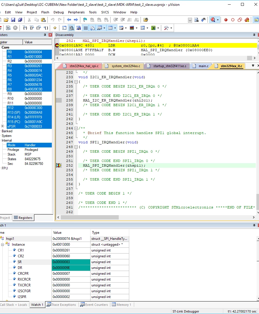

I'm very first to embedded programming, i have written a application using SPI protocol to communicate with 2 STM32F411 broads. And I got trouble in slave code, when the data from the master are sent to slave, then slave RXNE bit is set and go to SPI1_IRQHandler but if i go to HAL_SPI_IRQHandler(&hspi1), this bit is automatically clear while DR is still have data ? Do i need to check anything ? Or Can you tell some bugs possibly happen in my application ? Tks you so much .0690X000006DulSQAS.png0690X000006DulNQAS.png

Don't inspect them in the debugger, it doesn't have magical powers, reading and dumping DR will still clear RXNE in SR.​

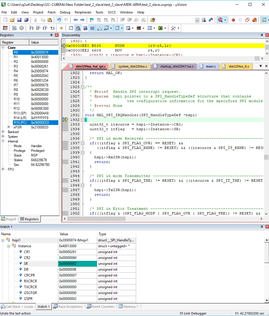

This bug is really weird for me, the program just jump to another function , why is SR changing. I think there is some factors causing this bug ? If i dont believe with the debugger , which is i should use debug my code?

You need to have your code inspect the value in SR, put it in a RAM variable, and inspect the RAM variable. The Instance pointer points to the peripheral registers directly. Learn to instrument your software so it can report status and flow in real-time without stopping the machine or sticking your fingers in the gears.
Like repeatedly opening an oven to see how hot it is, put a thermometer in the oven, and look through the window at it.
This is a Schrodinger's Cat issue, you are altering the outcome of the experiment by looking in the box.

WARNING: If you show the SPI DR regiser when debugging, the ST Link will make a read register access to display the content. This may cause some SR flag to clear when breakpoint. This is the classical side effect when debugging...

Normally you have to open a peripheral view, HAL mixes that up by having an Instance pointer, and now the mere decomposition of a structure/variable causes it. And perhaps anything else silently walking the trees.
