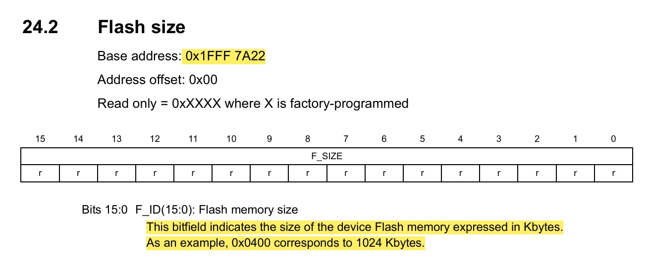

The flash (ROM) size can be read from the chip itself in the flash size register. But the toolchain FLASH_END will also work.
No better way to calculate SRAM other than what you're doing, which will work if you don't modify the startup file.
