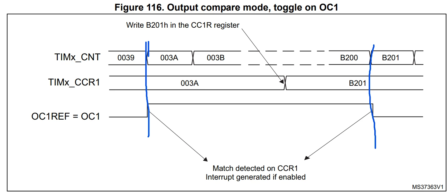

As far as I know, output compare mode keeps a value in timer registers and when counter value matches with the value in the register, then the pin generates an output according to the behaviour the user specify.
0693W00000aIBjlQAG.pngI am learning these concepts so that's why I am using output compare. I do not need pwm signal for now.
I hope everything now is correct and dont misunderstand something about these concepts. I looked at reference manual and knew these modes of timers. I then wanted to use it now am trying to implement.

RED_LED is PB0, and that is TIM3_CH3. You are setting up and enabling TIM3_CH1.

You didn't write a word about pin configurations. Do you set the pins as timer outputs or you want to control them with software from timer interrupt service routine?
Also, I still don't understand why you don't use PWM mode for LED control. It's the only natural choice here.

Sory for that, KY017_Module_Init function does the pin configuration, if I didn't do anything wrong.
Actually I could do this with ISR but I dont wanna do with that way if I can do this without any line of code, and I saw that there are lots of video on YouTube that they toggle LED with output compare mode.
Because as I said, this is not a big project. I made this up my mind to learn timer modes. I am planning to work with PWM later to learn that as well. But as far as I know, PWM is used for generating analog signal according to Ton/T, right? Why should I use PWM to toggle an LED? Maybe I miss a point about PWM and I am sure you are completely right for this issue and please let me know if so that I can try this way also later.

Read out and check/post content of TIM and relevant GPIO registers.
