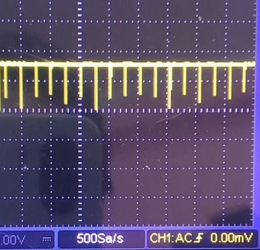

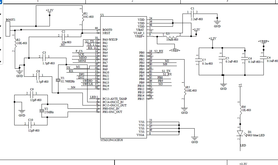

     I am facing a wired issue in programming the  mcu . I have designed  a custom borad with STM32F411CEU6 (QFN-48 package). DFU mode is is properly detected.  But whenever I am trying to connect the mcu  with STM cube programmer in dfu mode mcu gets resets.
  Some of the things I have observed:
      1. VCAP(1.3067V on vcap pin) Voltage drops  by 0.3V while trying to connect with cube programmer.
      2. MCU connects easily if I apply a little bit of heat . Disconnects again as soon as the mcu cools down. This kind of behaviour  I have never seen with ST mcu.

  I have attached the schematic and pcb layout along with this post. The hardware is tested already with previous pcb design. Due to  some size issue I had to change the layout and found this issue.This is the new layout with fresh components.This is my second iteration. I will be very greatfull if you could guide me a little bit.

MM..1
January 25, 2025
VBAT require be connected to 3V3 too.
Chayan Roy
January 25, 2025
Hello MM..1,  Thanks for your repsonse.
  We have already tested the hardware in our previous pcb design. Now only the layout hase been changed. Not the circuit. The issue is comming in new layout. But i will try out your suggestion.

Sounds like a hardware assembly issue. VCAP dropping suggests insufficient or invalid power. Perhaps a VSS connection is flaky. NRST pulsing suggests the chip is resetting internally likely due to a power issue.
Does SWD mode work?
Does 3V3 also drop when trying to connect? (Use a scope to see if drops correspond to NRST.)

The issue has been solved . VCAP capacitor gorund was missing on pcb. I have soldered a piece of wire to connect vacp negative to ground. Thank you every one for your valuable suggestions .
