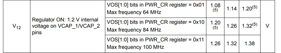

I seem to behaving an issue getting my STM32F411  PLL to stabilize using the HSI. The code I am using shown below. Setting it to 100MHZ.  The code gets stuck in RCC_GetSYSCLKSource() != 0x08 ) continue; . It never returns 8.  I had originally got stuck at while( RCC_GetFlagStatus(RCC_FLAG_PLLRDY) == RESET ) continue;
until added the flash wait state. Any ideas what I am doing wrong. I have run out of ideas at the moment. Any help much appreciated. Thanks Clive

Dear @cpalmer54 ,
You need to ensure that internal voltage V12 is set to Power Scale1: Regulator ON,
VOS[1:0] bits in PWR_CR register = 0x11 to be able to run up 100MHz.
Having 2 wait states of Flash is not enough, See table 15 Here Datasheet - STM32F411xC STM32F411xE - Arm<Sup>®</Sup> Cortex<Sup>®</Sup>-M4 32b MCU+FPU, 125 DMIPS, 512KB Flash, 128KB RAM, USB OTG FS, 11 TIMs, 1 ADC, 13 comm. interfaces   if your VDD is 3.3Volts, 3 wait states are required at least.
also please share your schematics and in particular if the VCAP pin with the External right capacitor. you can see voltage level at that pin to see
Hope it helps.
Please note that in order to change PWR registers, you need to swtich on PWR module's clock in RCC first.

cpalmer54Author
Nov 4, 2024 6:32 AM UTC
That has done the trick. I'm very grateful for the help. Thanks for taking the time to reply.
