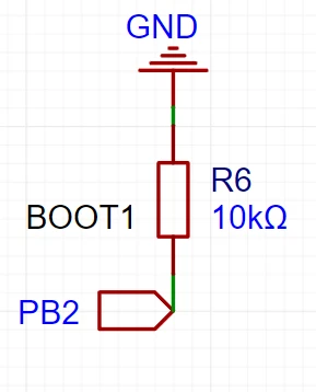

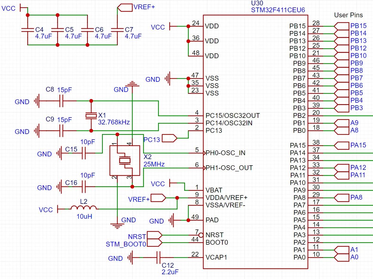

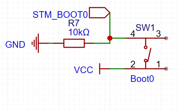

I've created a custom STM32F411CEU6 Board with external HSE und LSE. While the HSE works when running my user program, the Bootloader hangs within boot phase (i think).
When starting bootloader, BOOT0=1 und BOOT1=0. I powered direcly on VDD, no USB. I received no answer on both uarts after sending 0x7F. I also can't connect via stmcubeprogrammer. Only can only connect with stlinkv2.
I think it may be a hardware issue, but I can't find a solution.

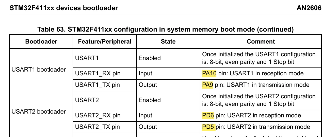

Here are the two pin configurations listed in AN2606 as supported:
If you don't have PD5/PD6 on your chip, you can't use those, so PA9/PA10 are the only ones available for you.
> I've checked uart1: PA10 PA9 -> it works, bootloader starts!
Good! Shows things are working as expected.
> uart2: PA3, PA3 -> doesn't work
PA3 won't work as it isn't listed in AN2606.

Schematic seems workable. It has minor issues which I don't believe will cause issues for basic bootloader functionality:
  • Missing 0.1uF decoupling caps.
  • VCAP cap should be 4.7 uF

AN2606 writes Port "PD", but I havn't any PORT D ...
