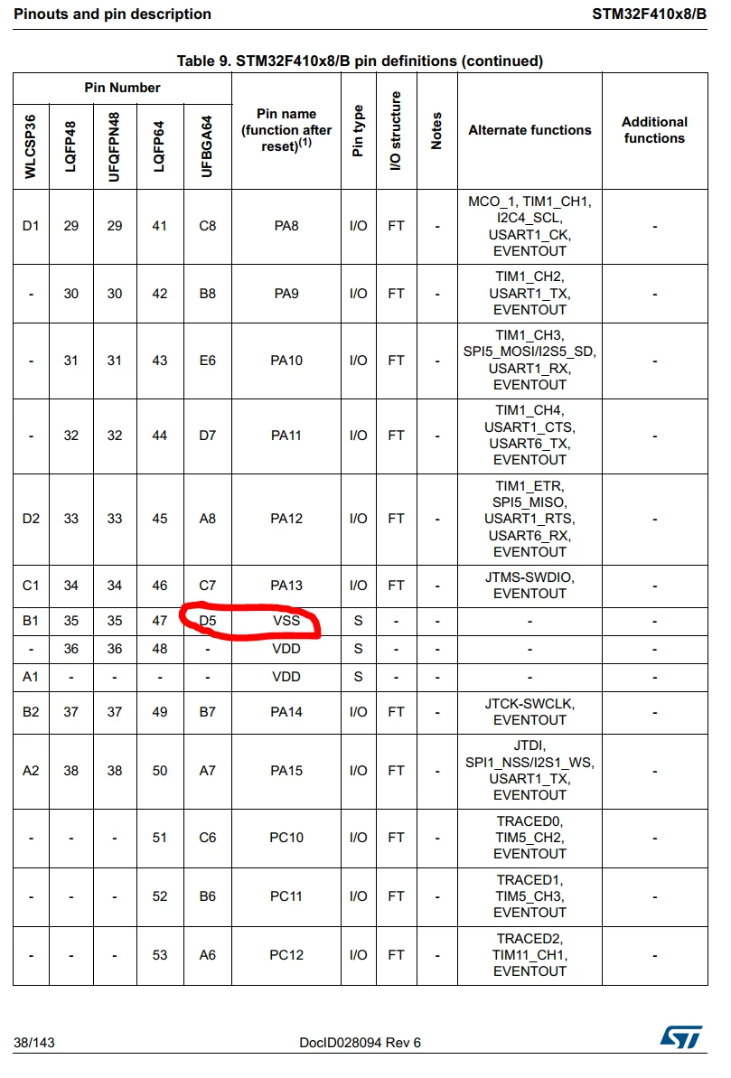

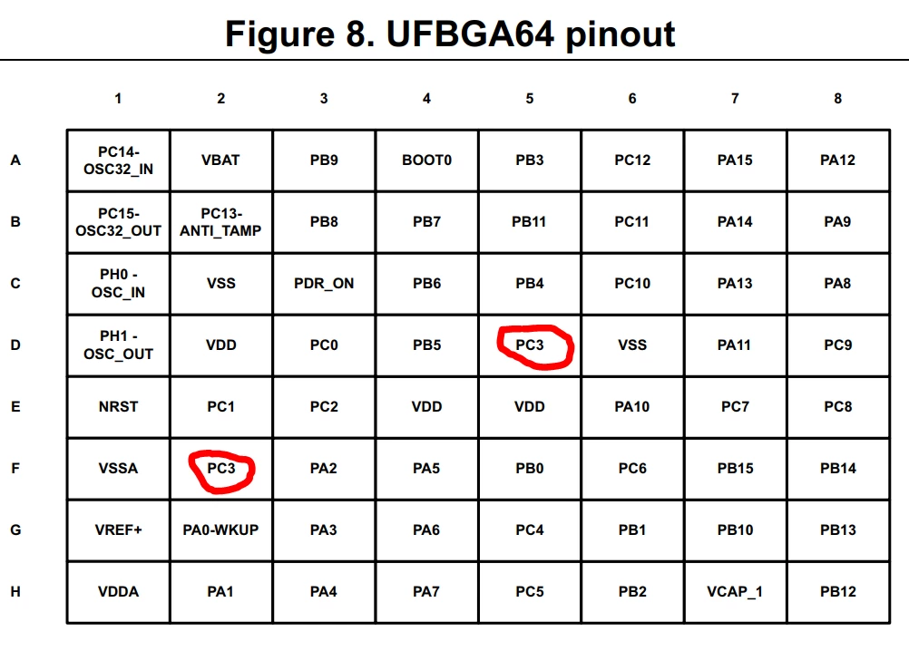

Hello ST,
This datasheet has few mistakes
http://www.st.com/resource/en/datasheet/stm32f410rb.pdf
PC3 is duplicated on this scheme. And also it does not correspond to the pin definition tables below.
Please, provide right pinout for STM32F410RBI.

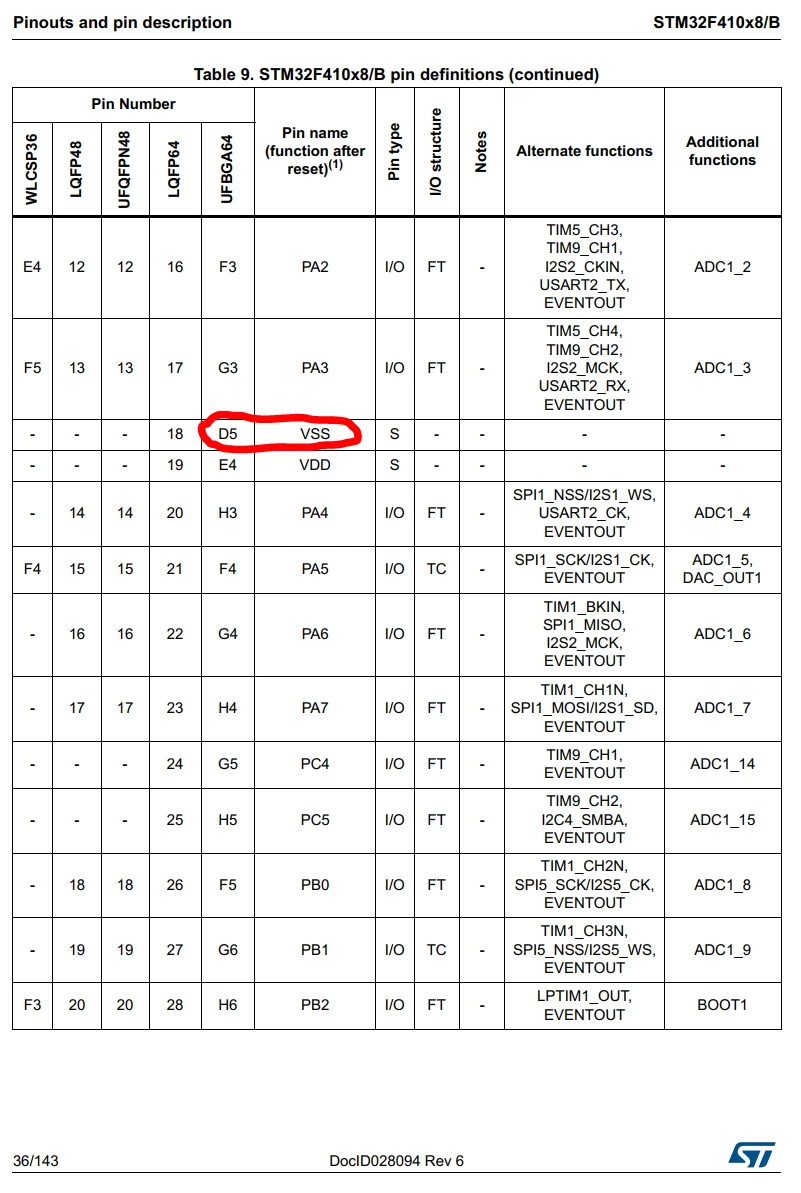

Hello
Please refer to the 'pin definitions' table not the pinout figure (PC3: F2 - VSS: D5).
This issue is confirmed and will be fixed on the next release of the document.
Thanks for bringing this to our attention and sorry for any inconvenience this may have caused.
Khouloud.
