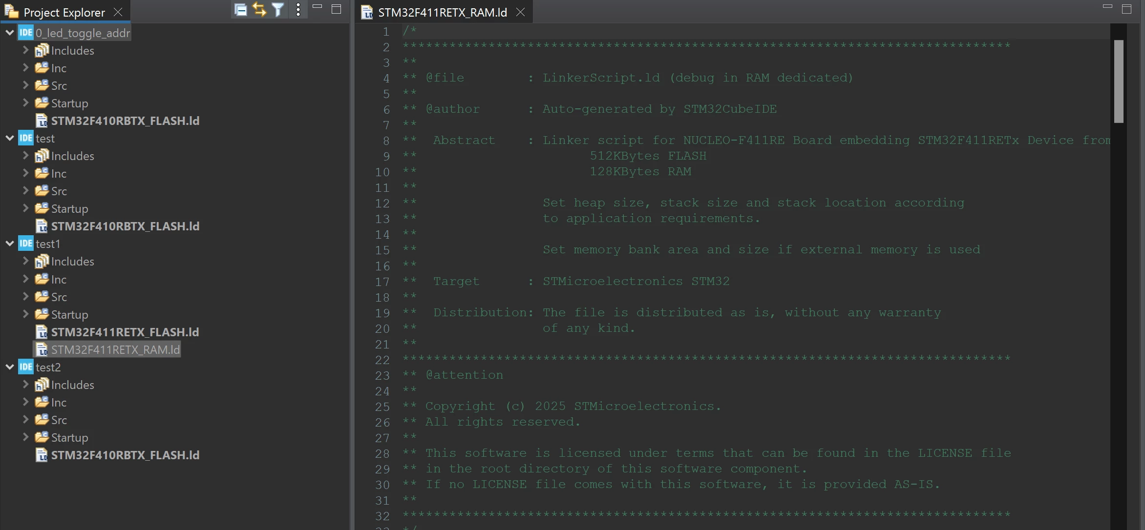

Screenshot 2025-01-23 155801.pngI am using STM32F410RB Nucleo Board for my developement. When I am creating new project chossing the same board STM32F410RBTX_RAM.ld Files is Missing. Due to which I am not able to flash my board and getting error.
On the other hand I tried selecting different board while creating the new project. So I choose STM32F411RE board and STM32F411RETX_RAM.ld file got generated
Please guide me through this.

Solved the issue. The issue was with the jumper cable on the board was connected in wrong manner. Jumper was connected between E5V. It should be connected between U5V. I am able to flash the board now. but still not able to see the RAM.ld file
