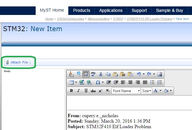

    You didn't see any attachments to my message because I have yet
    to figure out this, um, enigmatic forum software.  (Someone less
    charitable than I might have said ''demented''.)  I did try to
    attach some evidence, but the message got posted before I came
    close to figuring out how to attach anything.
