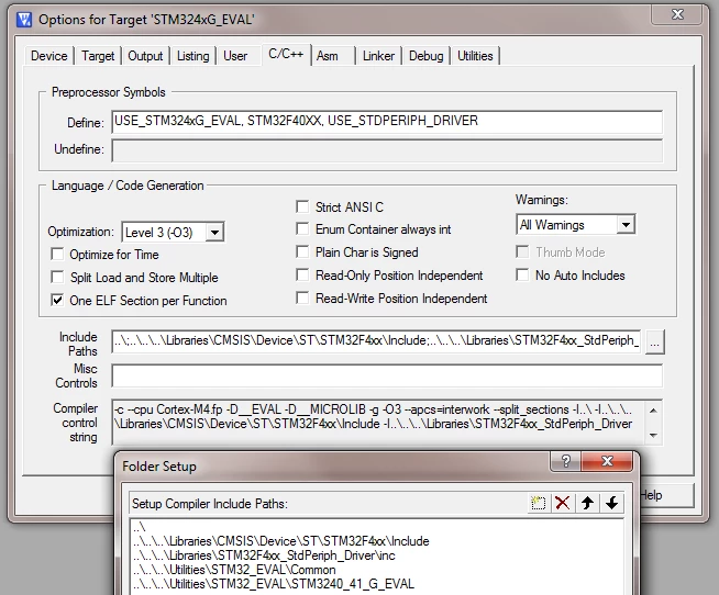

Am having this error,
&sharperror ''Please select first the Evaluation board used in your application (in Project Options)''
i commented   /* &sharpdefine STM32F427X */ in STM32F44XX.h but i still have this error , how can i fix it.

    Yeah, your not defining a BOARD that's supported, look at the #ifdef stuff above the failing line.
    USE_STM324xG_EVAL, STM32F40XX, USE_STDPERIPH_DRIVER

    it is resolved thank you but now i have this error :
    fatal error: stm324xg_eval.h: No such file or directory

    Ok, so you haven't correctly defined all the Include paths needed for the project (-I command line option list). You need to point into the Utilities directories containing the files the compiler needs to find.
    STM32F4xx_DSP_StdPeriph_Lib_V1.1.0\Utilities\STM32_EVAL\STM3240_41_G_EVAL

    You can also control the Include path search order, here is how the projects expect things to be defined. Adapt as appropriate.
