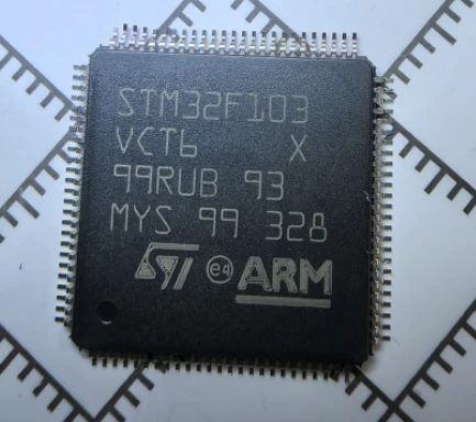

For the STM32F103VCT6 model in the picture, the date code (DC) is the 28th week of 2023. Why is there no 2D QR code marking? Didn't it come with a 2D QR code marking after the change in 2022?
Ray Ma
Visitor II
May 23, 2025
Hi Water,
According to PCN https://www.mouser.com/PCN/STMicroelectronics_MDG_23_13841.pdf, this change for COO of  Taiwan, and there is no document stating the change for COO Malaysia.
