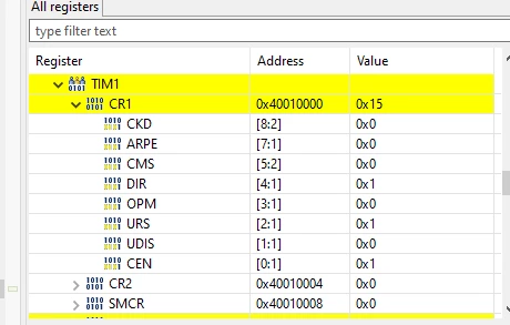

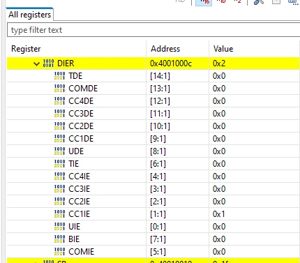

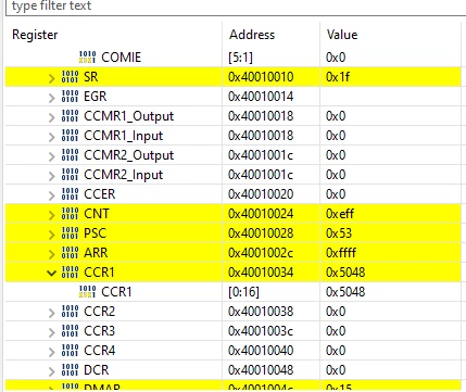

image.pngimage.pngimage.pngHi
Thansks for your reply .
I have another doubt which I am facing I am running timer1 at 1MHZ clock frequency so When I loaded value in ARR with (999) which represents me 1ms delay(Which is fine I am able to generate 1ms delay).
But when I am loading 999 value in CCR1 register instead of in ARR register (Note : I am getting delay of 500 microseconds and total wave is 1ms so I want to know Why  is it working like this can you help me with understanding.)
NOTE: I am working with downcounter and in my ARR register value is 0xFFFF.
I have attached screenshots of registers for better understanding.
B.R
Ashish
June 26, 2025
The Reference Manual goes into detail into how to timer operates.
Why are you loading 500 in CCR1? What is your goal here?
The screenshots show CCR1 is not 500.
