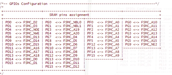

I am trying to interface an external SRAM with the stm32f407vg discovery board and i bumped into some issues with address pins not being available for FSMC.
As you guys might already know, the SRAM has both the Address and Data Pins. the one that i am using, is an IS61WV102416BLL 2MB SRAM. The problem i am facing now is that although the data pins D[0:15} are available in the discovery board, i realized the PFx pins which relate to the Address (in case of this ram i need [0:19]) are not available (some are, the once which are in the PDX pins). I found a code which I could work on and that configures the PFx pins to the very same SRAM but as i mentioned before, is not available in the stm32f407vg 100 pin package that the discovery uses.
Code:
https://code.google.com/p/yazanamu-iar-workspace-stm32f4-discovery/source/browse/trunk/STM32F4-Discovery_FW/Utilities/STM32_EVAL/STM3240_41_G_EVAL/stm324xg_eval_fsmc_sram.c?r=11
Configuration:
is there a way around this? could i use other GPIO's and use them as addresses?
I did do some research on this one and i read that one could use a latch(?) for multiplexing the address(?). is it possible to do it with the discovery board?
thanks in advanced for the trouble
    No.
    Yes. The FSMC has to be placed into multiplexed mode, and 16 bits of the lower address are to be latched by the NADV signal (PB7, FSMC_NL).
