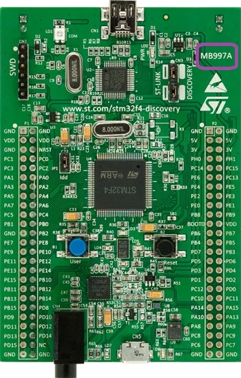

Tesla DeLorean
Guru
May 2, 2017 11:16 PM UTC
Posted on May 03, 2017 at 01:16
What version of the board do you have? Which accelerometer does it use?
Is this an official ST board, or a clone?
Jalal Sadigli
May 3, 2017 10:36 AM UTC
Posted on May 03, 2017 at 10:36
it is probably cloned one because i have bought it from china.
the accelerometer is
LIS3DSH
how to check version of board?
Tesla DeLorean
Guru
May 3, 2017 5:28 PM UTC
Posted on May 03, 2017 at 17:28
The colour of the board, buttons, and audio jack should be consistent with this image. The version is in the top corner, the newer boards have ''STM32F407G-DISC1'' silk-screened in the top-left corner, and a board ♯ MB997D
