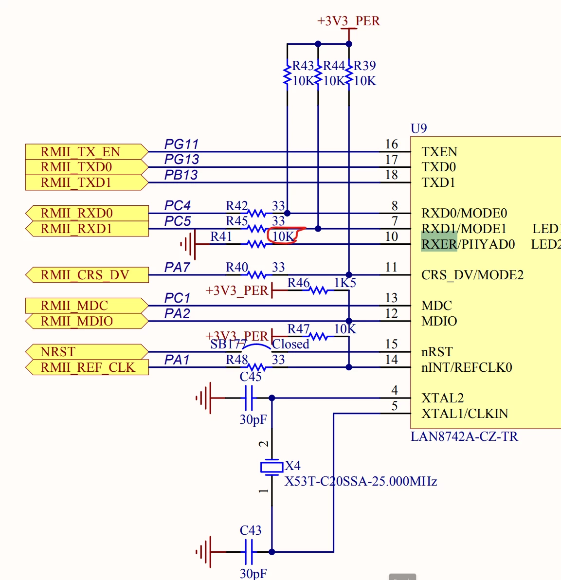

I have created Ethernet custom board using STM32F407 + LAN8742A attached is my schematic design based on Nucleo board for STM32F429ZI.

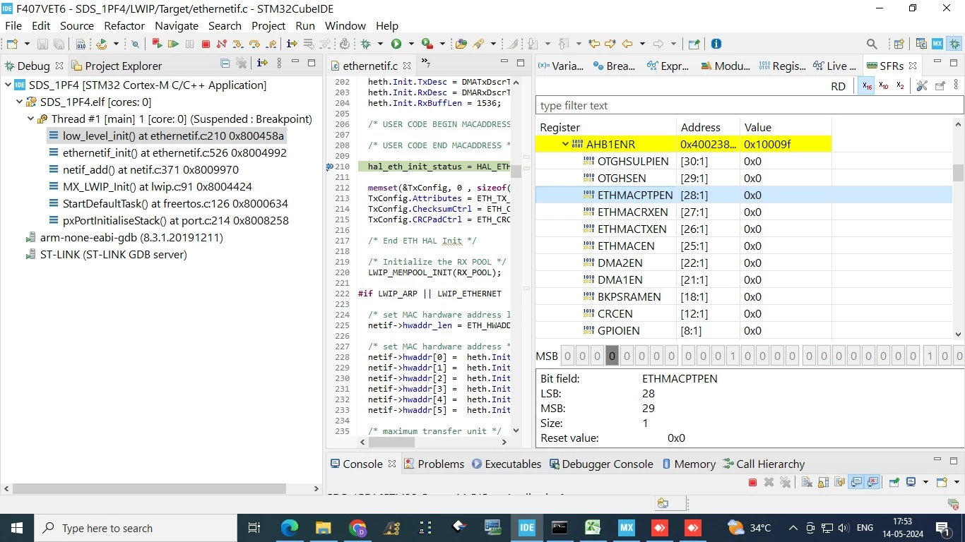

May 13, 2024
Hello @VivekBorse ,
this seems to be a clock issue in MCU side so check the following:
Check presence of the clock using oscilloscope and make sure is precise, check also if the MII/RMII switch is properly set in SYSCFG_PMC.MII_RMII_SEL
- check if all three ETHMACxxEN bits in RCC_AHB1ENR are set

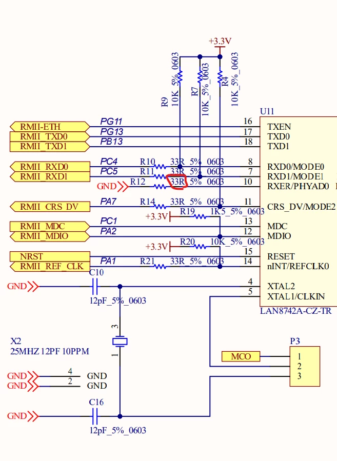

also, after a quick check of your design I find that it is not compliant with the schematic of the Nucleo F429 which embedded the same PHY.
the RXFER/PHYAD0 pin has 33-ohm resistor and in our schematic, we have a 10K resistor:
Nucleo schematic
check also if the Capacitor values associated to your crystal oscillator is compliant because they can cause the PHY to not initialize properly hence not being able to de-assert the software reset bit.
also checked your software everything seems to be set properly and the issue is mostly in the design of the PCB.

VivekBorse
May 14, 2024
HI @STea and @Tesla DeLorean,
thank you for quick responses
1. I checked the SYSCFG_PMC.MII_RMII_SEL in debugging mode it is getting set properly.
2. Controller External clk is 8MHz.
3. Tried checking DMA setting but controller goes in Error_handler after finishing HAL_ETH_Init() function

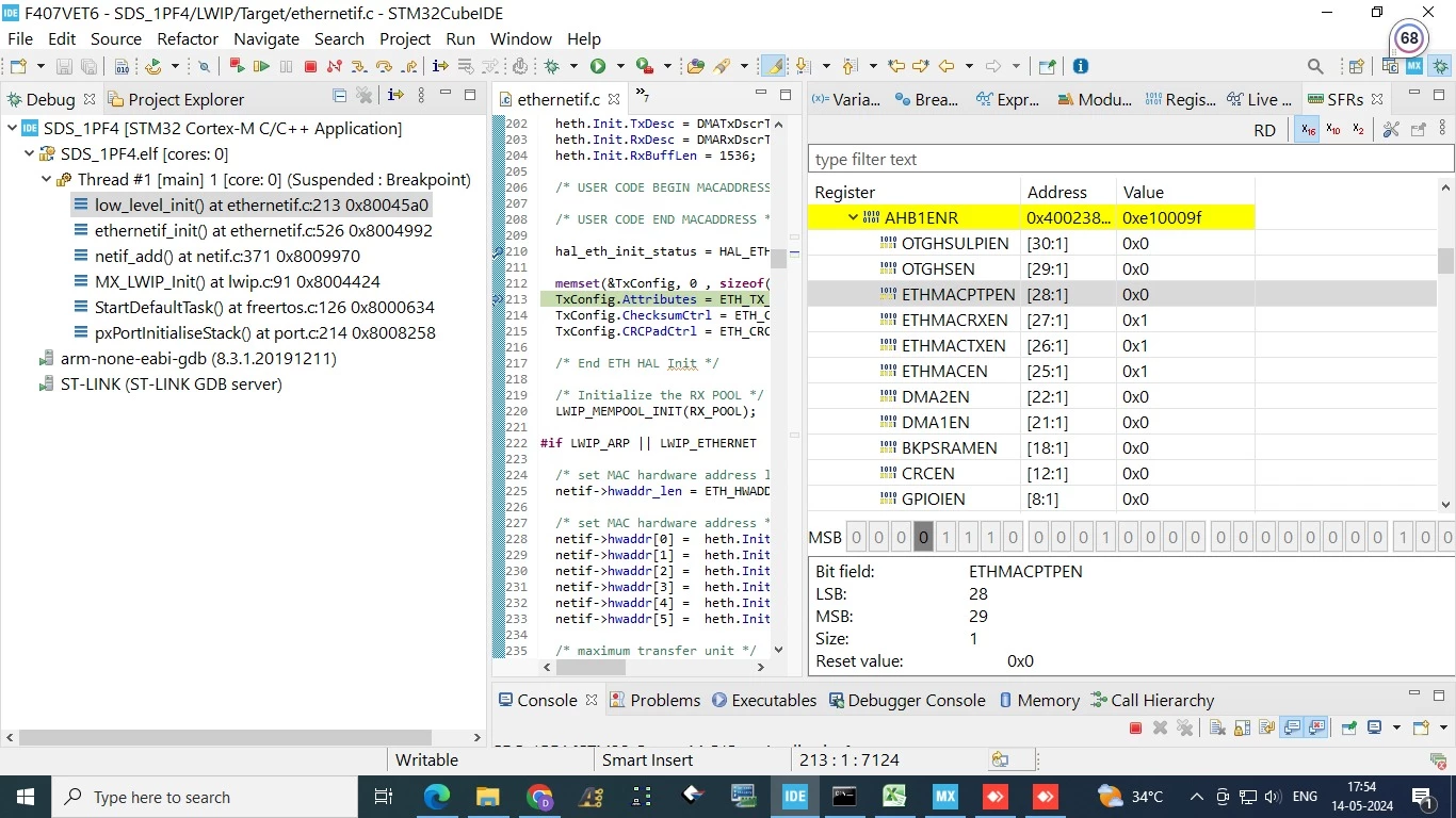

2. checked  ETHMACxxEN bits in RCC_AHB1ENR are set or not
Before calling HAL_ETH_Init()
after calling HAL_ETH_Init()

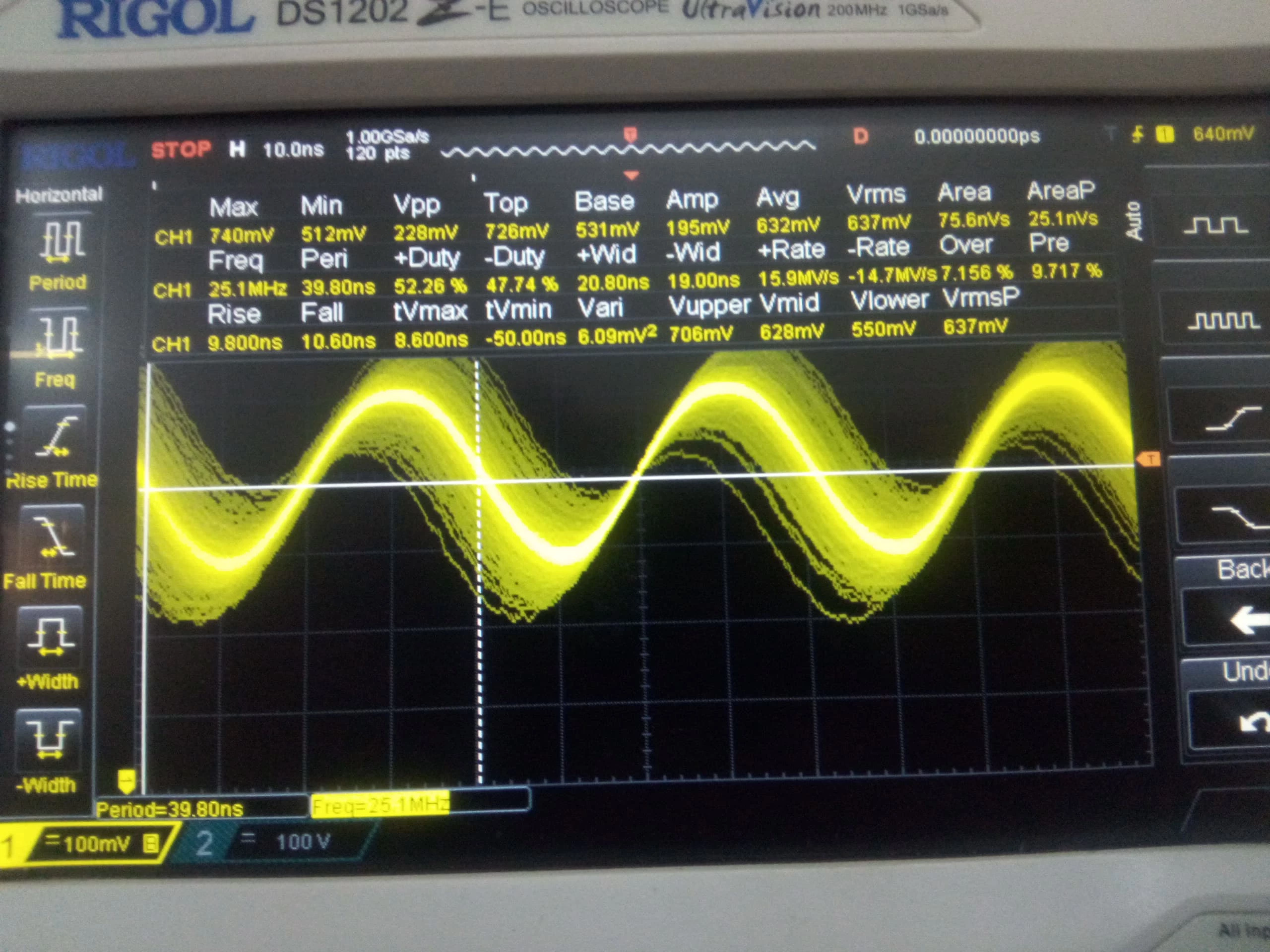

Changed the Resistor value for RXFER/PHYAD0 pin to 10K but issue is still same. on nucleo board after successful init I can observer 50MHz clock on Refclk0 pin but in case of custom board is not observed.

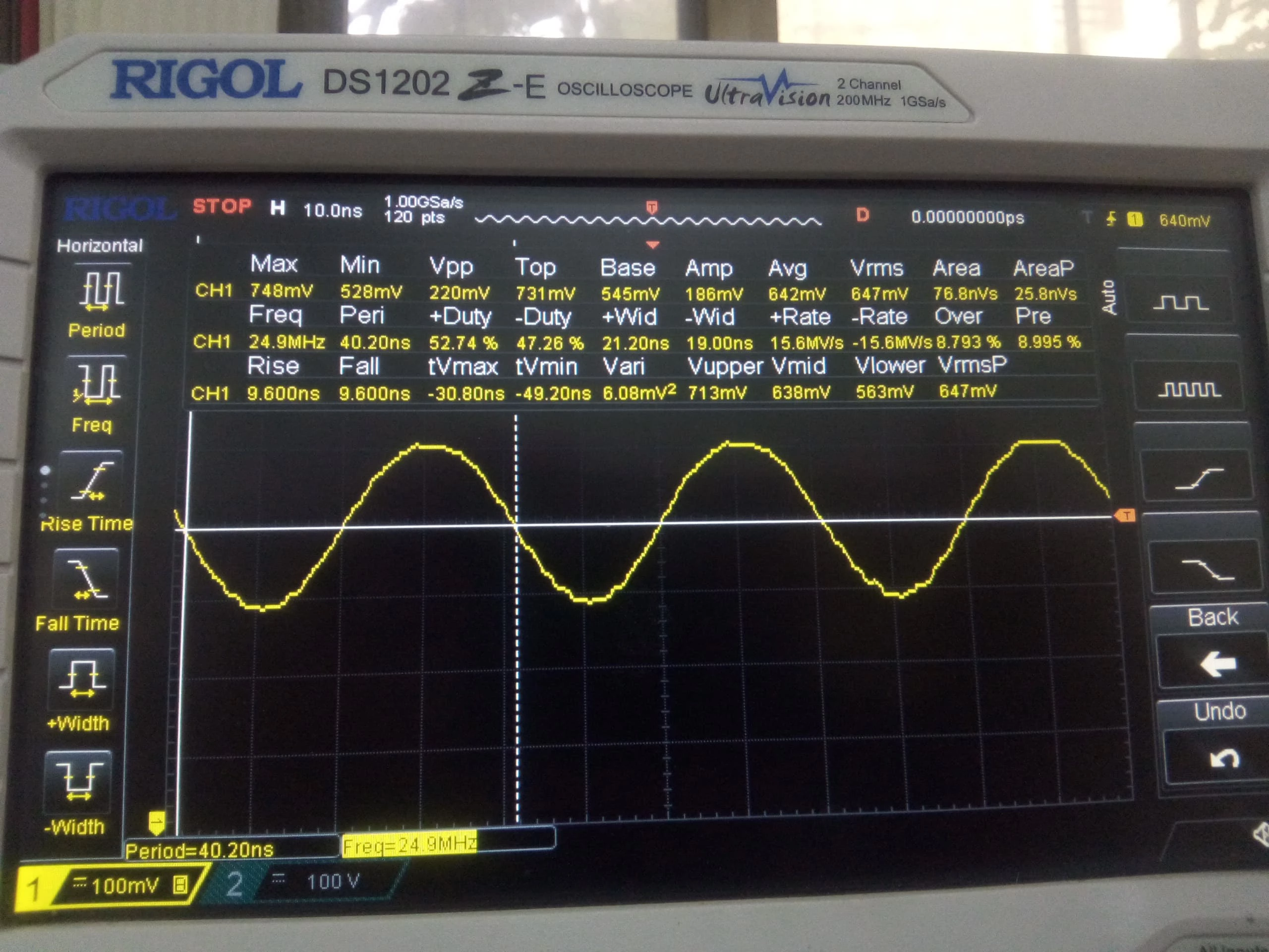

Following is the Clock signal observed for LAN chips on custom board with same of capacitor  value (30pf) similar to nucleo board.

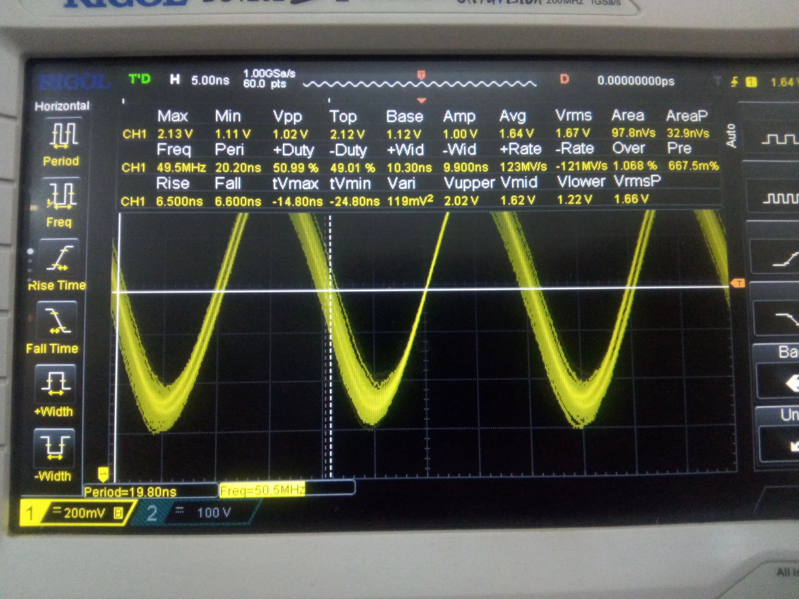

with similar part number for oscillator for LAN as nucleo board following is observed on nucleo board

Hello @VivekBorse ,
The clock on your costume board seems to be quite noisy I don't know the reason behind this, but I think it is related to your PCB layout, spacing ,routing ,isolation ...
