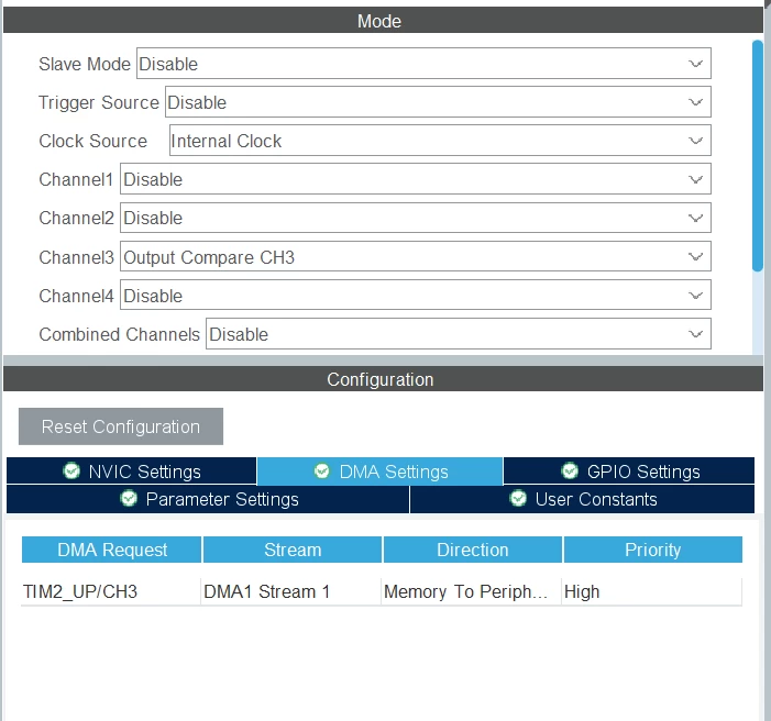

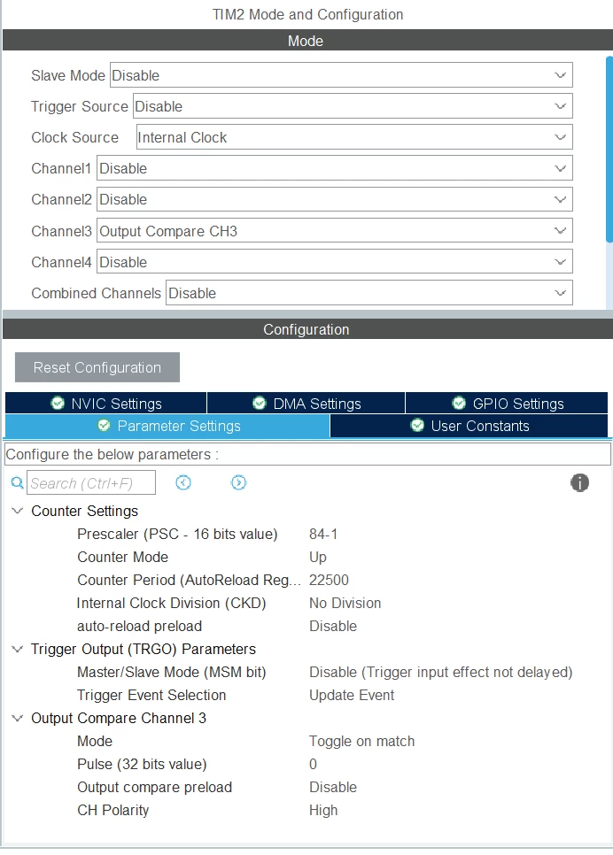

Hope you're well. I want to create a waveform using a Hardware Timer and DMA. Upon looking at other posts in the forum, it seems the best approach from what I have seen is to use a Timer in Output Compare Mode along with a DMA to transfer the pulse/waveform data from memory to the compare register.
Using a discovery board (STM32-F4), I set up timer 2 channel 3 in output compare mode to toggle and also DMA in circular mode to transfer half-words from memory to peripheral. And I initialized with HAL_TIM_OC_Start_DMA(). However, there is no observed changes on the output pin.
I have set up CubeMX as shown below and attached is the generated code. I appreciate any help setting this up, thank you.
Be more specific here. What kind of waveform do you want? What do you want to vary?
daded.1
daded.1Author
January 29, 2025
I want to generate a simple wave form that resembles a PPM signal.
| 1000 us | 500us | 1000us | 500us | 500us | 2000us | end of toggle after period is over
Basically, i want to toggle when the timer count has elapsed for each of those values in the array.
January 29, 2025
The example provided above can serve as a starting point, except that you should use HAL_TIM_Base_Start_DMA to start the timer instead of HAL_TIM_PWM_Start_DMA. This will update the ARR register with the array values at every cycle. Start the channel prior to this call and set it to toggle the pin on update.
