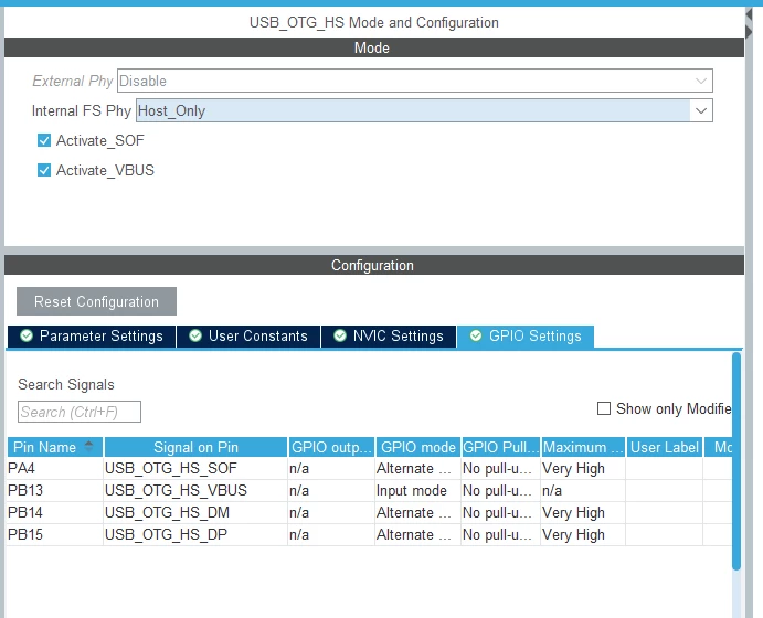

STM32F407 USB_OTG_HS hw recomendation
I use STM32F407 with internal PHY
What external elements need I for connecting USB flash to MCU?
FBLBest answer
February 17, 2026
Hello @Kuzma30
Did you refer to reference schematics from the MB997. For reliable USB operation, you should use the HSE clock source.
To give better visibility on the answered topics, please click on "Best answer" on the reply which solved your issue or answered your question.Best regards,FBL
