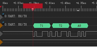

At the Pin RX of STM32F407 , capture the correct data written down by the host as following chart show

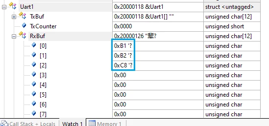

0693W000008x1SVQAY.pngBut got the following bytes content in the Rxbuffer
0693W000008x1R3QAI.png​

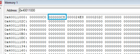

even in the memory location, the data in the DR reg is 0xC8 for the 3rd byte received, not 0xA8 shown at the pin's wave.
0693W000008x1TEQAY.png​

This LOW LEVEL error is resolved by changing the HSE_VALUE to 8000000HZ。
 #if !defined (HSE_VALUE)
 #define HSE_VALUE  ((uint32_t)8000000) /*!< Value of the External oscillator in Hz(25000000 default value) */
 #endif /* HSE_VALUE */
