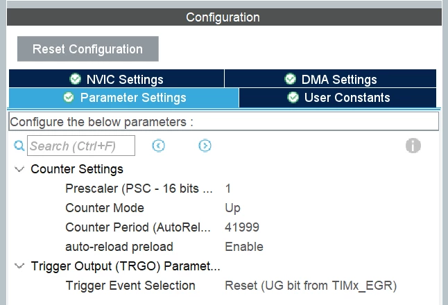

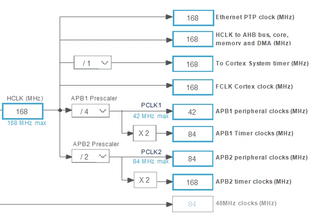

Hello everyone. I'm trying to use the TIM6 as a timer at 1 kHZ. However the result I get is 500 Hz. I couldn't figure out why.
I maxed the CPU clock speed at 168kHZ, which gives me the result of 84MHz APB1 Timer Clock.
I calculated the auto reload value using 1000 = 84000000/((PSC + 1) * (ARR + 1)) and got PSC=1 and ARR= 41999
Could you please tell me what I have done wrong in this setup?
