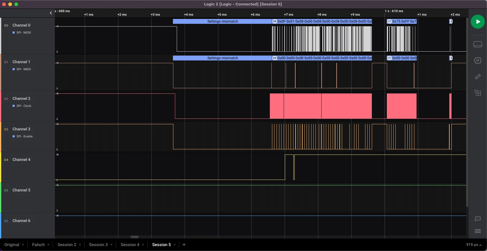

I have problems to initialize my SPI1 interface, and send a request. My Logic Analyzer Says that, after powering without a STLink.

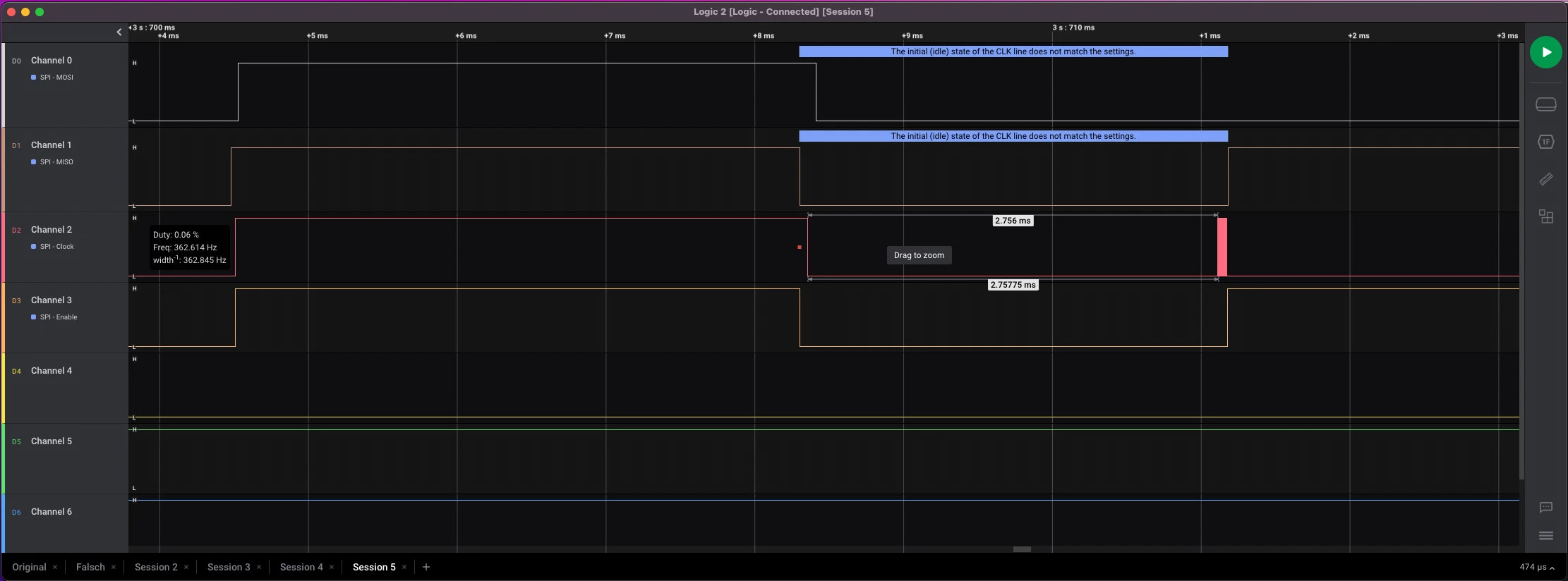

Now when I run my code with a STLink and Run:
So, can any one help me to try out the Problem?

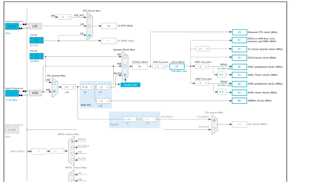

My Clock Config:
0693W00000QKClhQAH.png(I tested a blink example, that runs fine without STLink, and 1 seconds pulse)

 * @retval None
void SystemClock_Config(void)
 __HAL_RCC_PWR_CLK_ENABLE();
 __HAL_PWR_VOLTAGESCALING_CONFIG(PWR_REGULATOR_VOLTAGE_SCALE1);
 RCC_OscInitStruct.OscillatorType = RCC_OSCILLATORTYPE_LSI|RCC_OSCILLATORTYPE_HSE;
 RCC_OscInitStruct.HSEState = RCC_HSE_ON;
 RCC_OscInitStruct.LSIState = RCC_LSI_ON;
 RCC_OscInitStruct.PLL.PLLSource = RCC_PLLSOURCE_HSE;
 RCC_OscInitStruct.PLL.PLLM = 4;
 RCC_OscInitStruct.PLL.PLLN = 72;
 RCC_OscInitStruct.PLL.PLLP = RCC_PLLP_DIV2;
 RCC_OscInitStruct.PLL.PLLQ = 3;
 Error_Handler();
 RCC_ClkInitStruct.APB1CLKDivider = RCC_HCLK_DIV2;
 RCC_ClkInitStruct.APB2CLKDivider = RCC_HCLK_DIV2;
 if (HAL_RCC_ClockConfig(&RCC_ClkInitStruct, FLASH_LATENCY_2) != HAL_OK)
 Error_Handler();

waclawek.jan
June 30, 2022
Why do you think this has anything to do with SPI?
Debug in the usual way: toggle a pin at strategic positions of the code, e.g. between calls to individual initialization functions, and observe using oscilloscope/LA.

my code only contents SPI things…
and the clockrate is 8MHZ and the same code with stduino+platformio works without problems… and by the spi things, are many different….
waclawek.jan
July 1, 2022
This
MX_GPIO_Init();
 MX_ADC1_Init();
 MX_CAN1_Init();
 MX_USART2_UART_Init();
 MX_RTC_Init();
 /* USER CODE BEGIN 2 */
 //initGpio();
 RFM23 *rfm23 = new RFM23();
 /* USER CODE END 2 */
 /* Init scheduler */
 osKernelInitialize();
[etc.]
to me does not sound like "only SPI".
