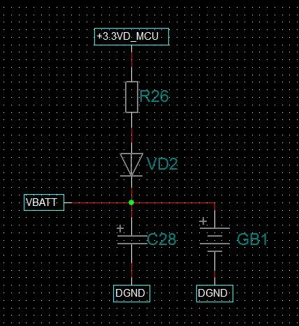

Good day. A strange problem. After turning off the power, the backup registers and the real time clock are reset.
Could it be that I messed up at initialization, or something that I missed?

The clock source is LSE. Vbat is connected through an ionistor. Ionistor connection diagram

And what does the debugger say about content of RTC_BKP_DR0?

@Community member​
After reset, RTC_BKP_DR0 = 0
If reboot without turning off the power, then RTC_BKP_DR0 = FIRST_DATA
#define FIRST_DATA 0x43B1

Verify that the battery is connected to the VBAT pin of the STM32 (i.e. that there is no bad solder joint).
Measure the voltage on the VBAT pin when supply voltage (VDD) is removed.
Also verify that VDDA is connected to supply voltage and VSSA is connected to ground.
Also, you do not set some pin as TAMPER, do you?
What is "ionistor"? [EDIT] Okay I looked it up, it's supercap. https://ru.wikipedia.org/wiki/%D0%98%D0%BE%D0%BD%D0%B8%D1%81%D1%82%D0%BE%D1%80 It appears that it's called so only in the russian language group, although it's a very apt name for this sort of parts. [/EDIT]
