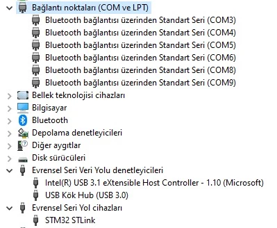

STM32F407 not appearing in the COM port section in device manager.
  • March 23, 2023
  • 4 replies
  • 4124 views
My main purpose here is to write sensor data into the text file. Planning to send the data through COM port and read and write the data into the text file using MATLAB. This is the only way to write the data into text file that I am thinking about without using any external hardware.
However, I cannot display the mcu in COM ports.
I reinstalled the drivers, I connected mcu to pc both with mini and micro usb.
I am not sure how to proceed, any help would be appreciated.
Thanks!
Enes

To see the COM port, there must be either a real COM port or a virtual one.
For a real one you need an UART-USB converter, for a virtual one typically a development board from STMicroelectronics.
Is the STM32F407 on a NUCLEO, a DISCOVERY or your own board?

It's a DISCOVERY board.

OK, we are talking about the STM32F407G-DISCO and the younger STM32F407G-DISC1 respectively, both of which still contain the older ST-LINK/V2-A without Virtual COM Port (VCP). Newer DISCOVERY and NUCLEO contain the ST-LINK/V2-1 with more functions, including the VCP.
However, there is a workaround that allows you to retrofit the Virtual COM Port (VCP) for the ST-LINK/V2-A, but this involves either some soldering or connecting a USART-USB converter. Details are in the UM1472 in section 6.1.3.
