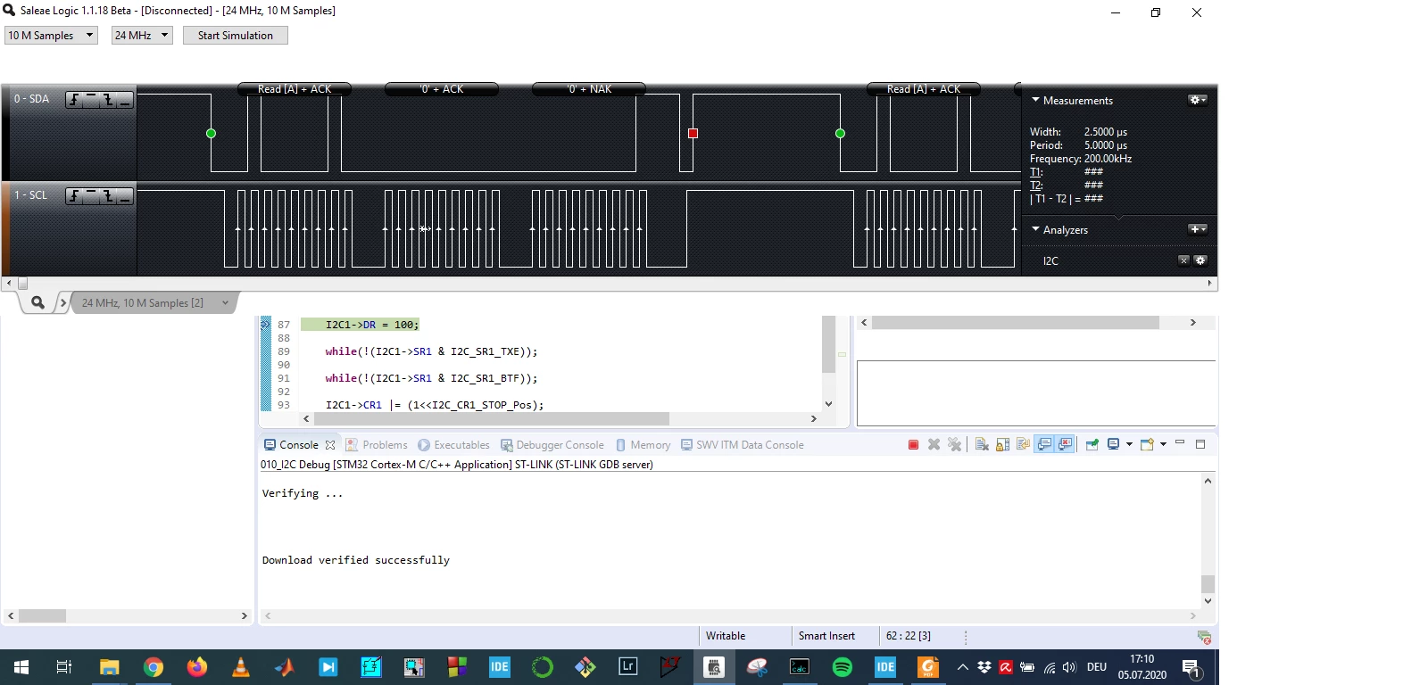

AAnth.1
AAnth.1Best answer
Senior
Jul 5, 2020 6:51 PM UTC
Oh wait. I am wrong on this one. On the 9th bit, an ACK is considered a logic low on the SDA line. So in fact, the address phase is acknowledged. And so is the data transfer of the 0x64 on the data line. On the 9th bit, SDA is logic low as well.
So it seems that my I2C is working as intended. That's great. :)
Now I just need to understand how to control the LCD with that. :)
Thanks for your support :)

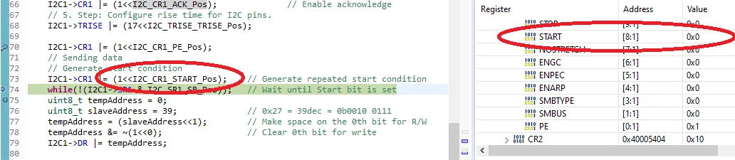

waclawek.jan
Jul 5, 2020 12:17 PM UTC
You have to enable GPIOB clock in RCC first.
Also, you want to put delay between enabling clock and accessing given peripheral, read errata.
waclawek.jan
Jul 5, 2020 12:25 PM UTC
Then there is this thing:
> I2C1->DR |= tempAddress;
where you surely don't want to do |= as reading DR has consequences,
There may be similar logical and sequencing issues, you might need to debug. Try to follow the RM.
The I2C module is rather tricky, and unless there's some specific requirement e.g. for speed , you may be better off bit-banging the master.
Jul 5, 2020 12:44 PM UTC
> while(!(I2C1->SR1 & I2C_SR1_SB_Pos));
You're using I2C_SR1_SB_Pos where you should be using I2C_SR1_SB. This mistake occurs on a number of lines both before and after line 42.
AAnth.1
AAnth.1Author
Senior
Jul 5, 2020 3:19 PM UTC
Thank you TDK. This helped solving one problem. I am now leaving the while loop after a true condition as I should be. But I still cannot seem to get the I2C working. I hooked up my logic analyzer while the breakpoint is set to writing the data register, and I seem to have a fundamental problem here. Although I intended to set up the SCLK frequency to be 100kHz for SM, I seem to have a SCLK of 200kHz, where Thigh is 2,5us instead of 5us. This is mystic to me! :\ I am using HSI with 16MHz and set 80 into the CCR register. 16MHz/100kHz = 160 as a full period. Half of that is Thigh, thus Thigh=160/2=80. It seems like I am running twice as high as I should be.

Jul 5, 2020 4:13 PM UTC
So double CCR. Read the CCR register description to find out your mistake.

Jul 5, 2020 12:49 PM UTC
Hi Jan
Thank you for your answer. I enabled the GPIOB clock in RCC now and implemented a delay after each peripheral bus enable. See below code. Also, what I noticed during debugging is, that the start condition is not generated at all, even when setting the bit. See the attached figure. So clearly, when the start condition is not generated, the status bit will never be set. I believe I messed something up in my I2C configuration, or what could be the reason that I cannot set the start generation bit?
Thank you,
