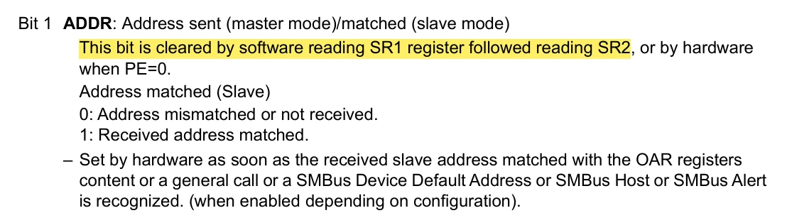

Hi, Im new to STM32 and writing a bare metal interrupt based i2c library. For some reason addr bit clears itself automatically even though im not reading sr1 and sr2. I also have problems with debug mode, if i decide to step over the function that sets up the interrupt for I2C1_EV_IRQ it sometimes causes debugger to skip the interrupt, it happens randomly. I had some problems with the built in debugger.

 //ADDR BIT CLEARS ITSELF CANT GET INTO THIS IF STATEMENT
		if(I2C_CheckBitStatus(&i2c->i2cReg->I2C_SR1, 1))

What leads you to believe the bit is clearing itself?
Reading registers with the debugger has the same consequences as reading them with the program. Namely, reading SR1 and SR2 will clear the ADDR bit.
DefensiveAuthor
August 24, 2025
I was checking the SR1 register for the addr bit in the SFR. Is that what causes the addr bit to clear itself?
