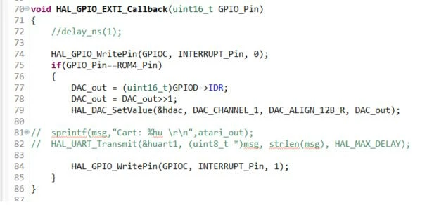

The code inside the interrupt:
1 - set output pin PC9 to 0
2 - read the GPIOD (al 16 bit)
3 - shift once (divide by 2)
4 - output the result into the MCU DAC.
5 - set output pin PC9 to 0

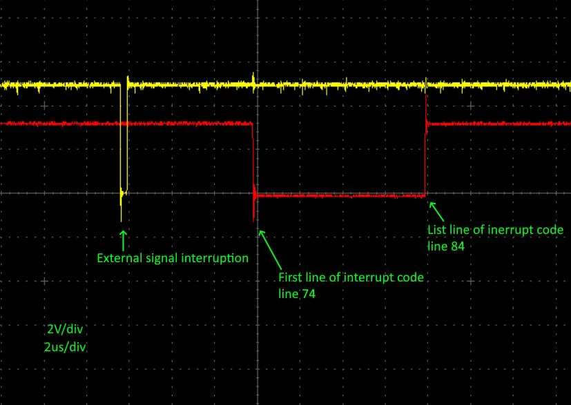

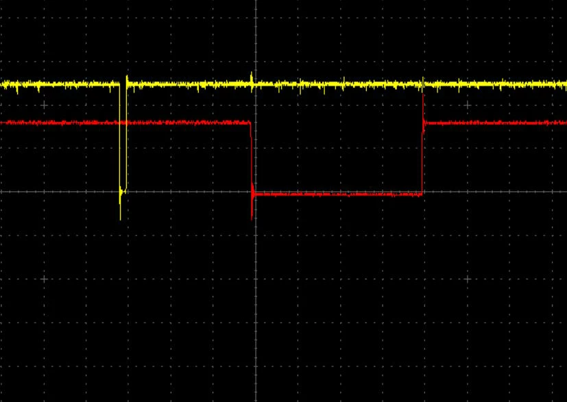

I use PC9 on an oscilloscope to see how much each line of code is taking.
And I am very surprised by how slow the code is running at.
First, it take 6us for the interruption to be triggered
Then 3us to read PDx registry
1us to shift
4us to output to DAC
I was hopping the interrupt would be much faster. At least to read the PDx registry within the 400ns. 400s is the time I have to read the GPIO. This is how long the data stay on the 16 bus.

It will be much faster if you implement the EXTI handlers themselves (e.g. EXTI0_IRQHandler) rather than using the HAL callbacks. 12 cycles to enter the ISR, then look at disassembly to see how many cycles it takes to get through your code.

You didnt state the cpu clock you have...
At 168MHz , max for F407 , going to an INT will need about 80ns . (12 x 6ns + some clocks for sync )
If you want to see/check the speed, at first check the cpu speed, you set.
Then use optimizer -O2 setting , or -Ofast .
And use only direct write to registers , port or DAC, not the HAL calls.
And not call next level of functions (callback) in INT, that adds all the time for a subroutine calling+return.
And dont expect wonders....its still a cpu, that saves+ restores all registers in a INT or function call, so some time will be needed.
May 18, 2025
ah, I did not notice I left the clock settings to default. the CPU was at 16Mhz !
Now at 168Mhz, I see a big improvement. the whole code runs in 1.5us from the signal going down.
