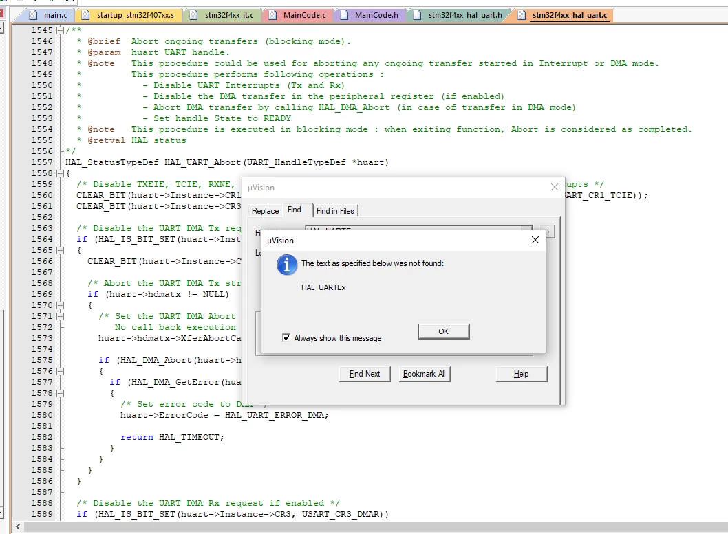

STM32F407 HAL_UARTEx_ReceiveToIdle() function missing
Hello. I am working on a project where i need to get different lenghts of data using UART and preferebly with least possible amount of iterrupts, so ive settled to using HAL_UARTEx_ReceiveToIdle() function (when testing the project on F103), but when i moved the project onto F407, i cant seem to find this function.. Was it for some reason removed or renamed, or is my enviroment messing with me?..

0693W00000LvWswQAF.pngIm looking into Keil Uvision IDE suggestions and stm32f4xx_hal_uart.c file which stm32cubemx generated. Ive seen that it is there on the github, but hal_uart.c which cube generated seems to be different than the one in github

You might be on a much older version of the library. It's been in there for a bit. Update embedded packages in CubeMX. You can see which library version you're using in Project Manager -> Project -> MCU and Firmware Package.

Just updated to newest package version, still cant find the function. I guess its something on my end being not correct, will try to find a workaround, time to play with DMA i guess to save some time on iterrupts :)

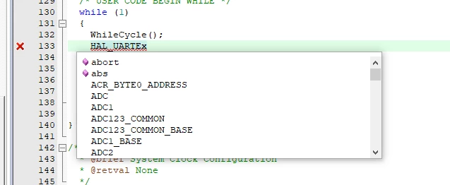

For testing purposes, just created a new cubemx project, generated fresh code into a new folder, function is still missing. Where im checking - testing if Keil Uvision can autocomplete the function based on all the funcion names in files, aswell double checked the files in /Projectfolder/Drivers/STM32F4xx_HAL_Driver/Src/ Both HAL_UART.c and HAL_USART.c - function doesnt exist anywhere.

Not sure, sorry. Perhaps the files in the repository location were replaced manually. Perhaps IOC isn't using the latest library version. Those are things I would check. Could also generate the project for CubeIDE and see if results are different. Good luck.
