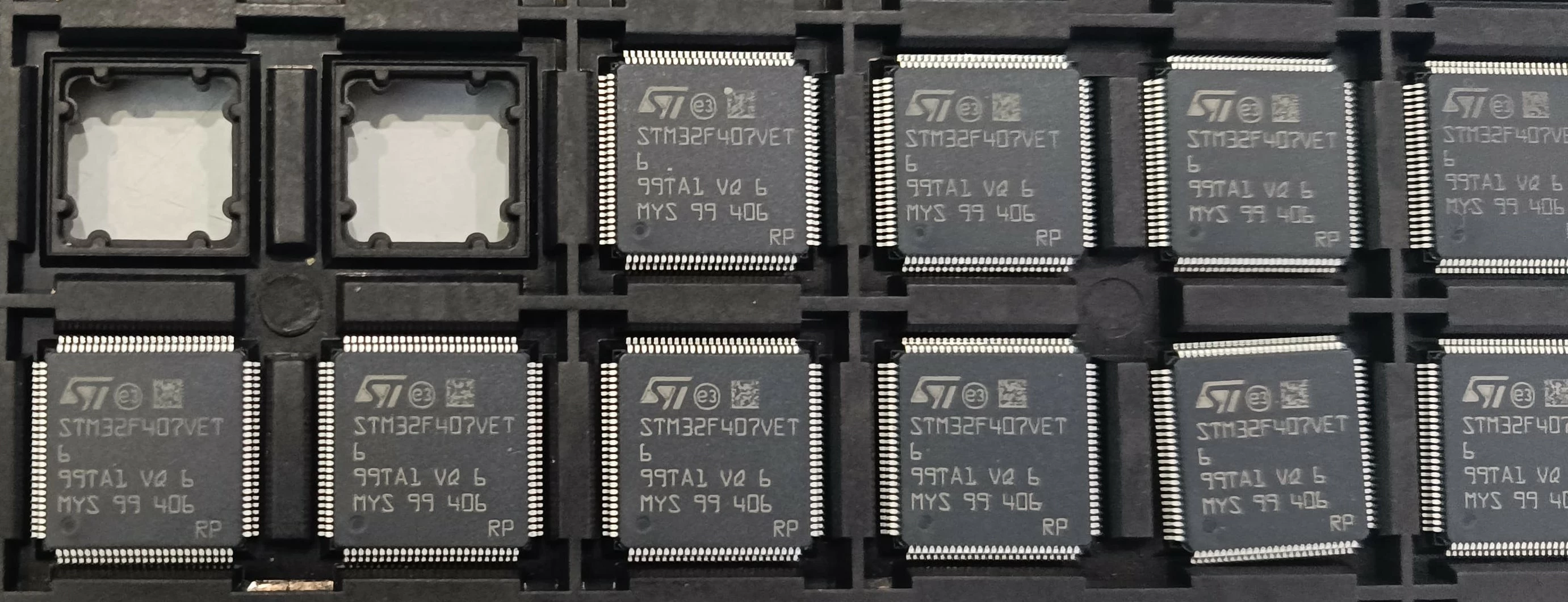

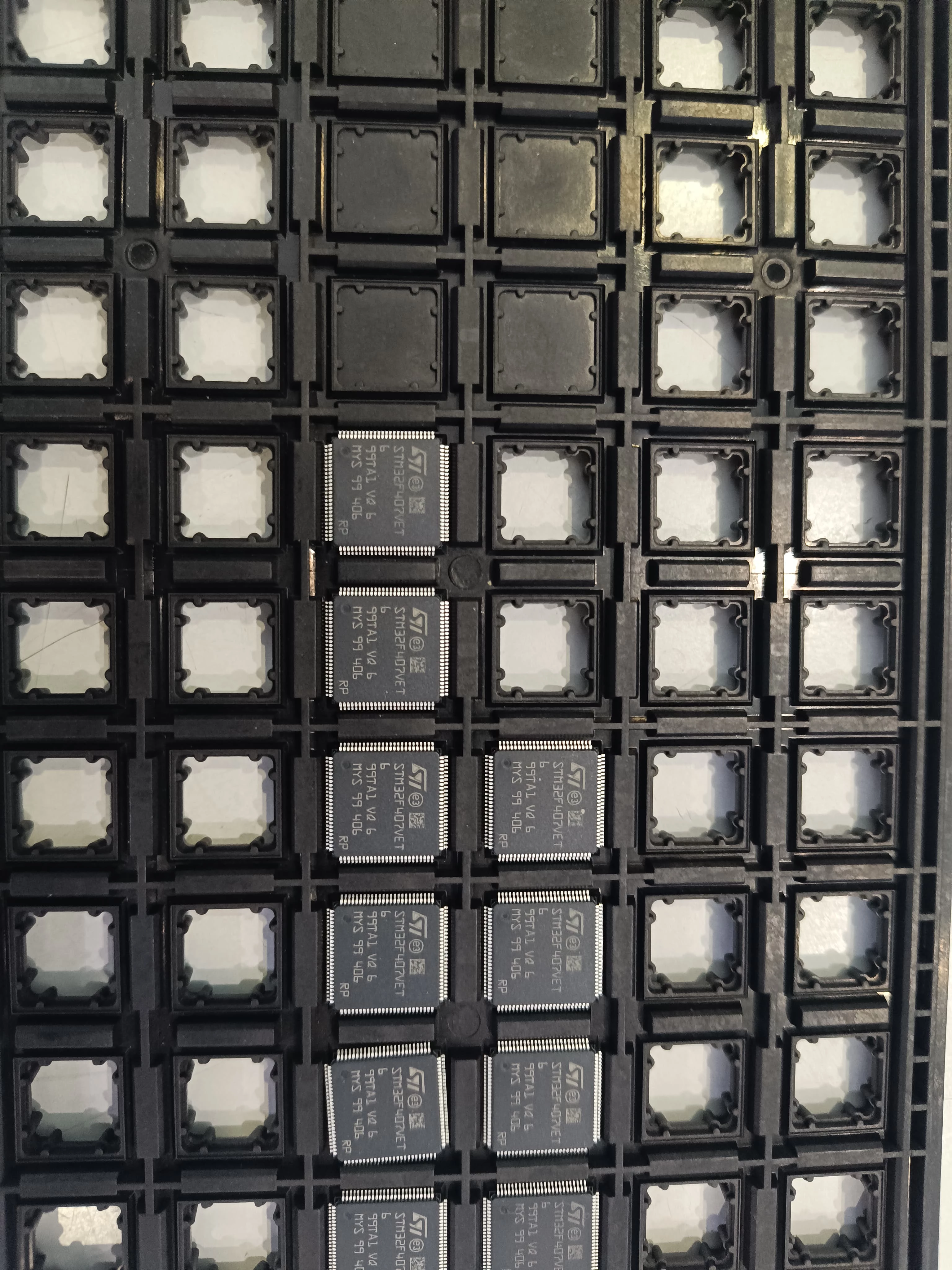

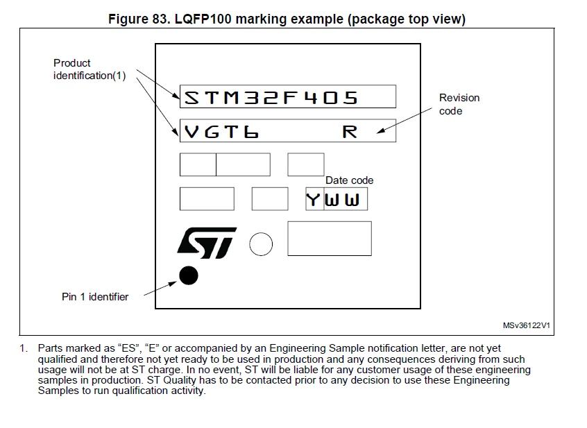

Suggest the the product STM32F407VET6 is Fake or Not .. How to find fake products . The lables are not as per in Manual . WhatsApp Image 2024-09-26 at 11.54.31 AM.jpegSTM32F407.jpeg

refere below image , both are different , can you suggest me anything about this

Dear @SureshP
We introduced this change last year on this particular package from our Backend factory in Taiwan . You refer to this PCN - Product Change notification where we changed Gold to copper and introduced in same time the 2D QR code marking , with no more ARM Logo .
https://www.mouser.com/PCN/STMicroelectronics_MDG_23_13841.pdf
Hope it helps you .
