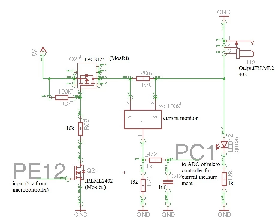

I have a relay circuit which has fourteen relay output (i.e 14 devices can be switched on or off from this) , I have attached the circuit for a single output.
I am sending command to switch on the related output through the GPIO of a STM32 f4 discovery  board .
I am reading 14 channels of ADC1 in scan mode with multi channel configuration to get the power consumption through each output
I am Using following ADC pins for getting the data.

My first problem is that I am constantly getting value on PC0 (even though there is no load) because it is internally connected to the temerature sensor..How Can I disable this connection of internal temperature sensor so that I can use this pin as a channel of ADC.
Second problem is that at PA5 and PA7 I am also getting the voltage level without applying any load...
I have detached my board with discovery and check the pins individually and I saw that PA5 and PA7 are producing constantly around 2.5 Volt ...why..

The manual for the STM32F4-Discovery would illustrate why pins wouldn't be useable. PA5,6,7 are attached to the LIS302DL
You'd have to remove parts or cuts traces to free up the pins. That or buy a break-out board that is free of all this other circuitry.
