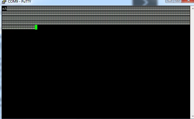

i am new to forum, and also to stm32 discovery. So please some patience :).
I am trying to send from discovery to PC.
Tried with USART6 + UART2USB and in putty on PC everything works.
Then i connected HC-05 to same USART6, just set baudrate to 38400 and tried again.
Everytime i reset whole system (connecting BT, running code) in manage to get 2 character aA but then just ▒  signs. I do not understand, what i missed. My code in bellow. I tried to lower to 9600 without success.
Any idea or advice for lost begginer?
thank you for help, with regards
Robert

    So indicative that the wireless link fails..

    Ok, so this could indicate failed connection - means that on discovery would be everything right, i have to find out, why connection fails ...
    Just one thing ... I send char every 0,2 seconds to PC- and when connection fails, this should stop ( i think). But every 0,2 i get one
    sign. Like discovery is still sending, just something is wrong with data. Is this logical? I do not belive, that putty has some cache and shows randomly. And if i debug step by step when i click next, then i get next char, so putty is still under control of MC.
    with regards, Robert

    The code is not unreasonable, you could perhaps use 2-stop bits, but I don't think this is a synchronization issue.
    You could also use other terminal applications, like RealTerm or TeraTerm.
    You could use a scope or logic analyzer, and confirm for yourself that the data coming out of the STM32 is correct. You could also fork the TX output and connect that via a USB-to-CMOS-Serial adapter in addition to the BlueTooth route.

    Default baudrate is 9600 unless you have changed it with the AT commands or pin34 is at high level.
    Would advice you to spend a bit more money for example for a http://www.lairdtech.com module, they are so much better and well documented then the chinees modules with there crapy translated manuals.
