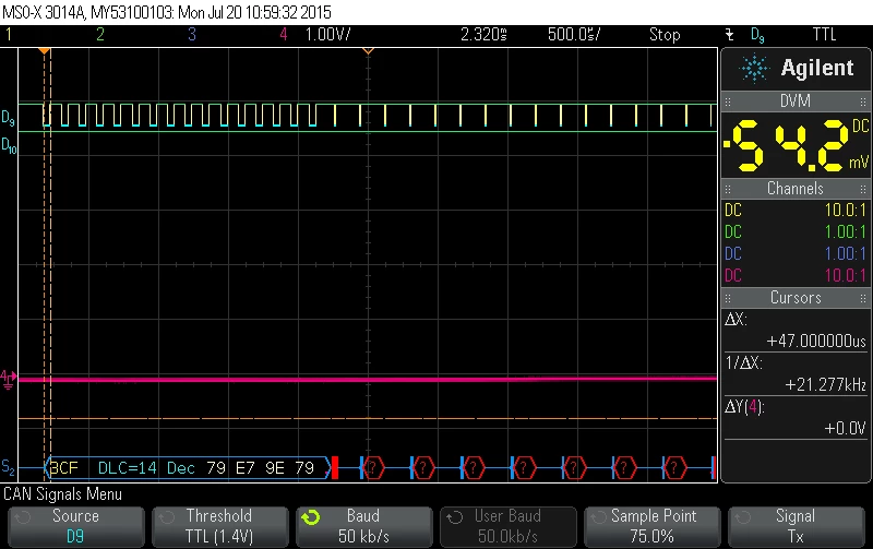

Hi Guys,
I'm struggling to activate the can bus in the CAN2 module in the discovery eval board.
Using CubeMx, Generated all the initialization code.
Set baud-rate to 50KHz, and to loop-back mode.
The output waveform looks very strange, and does not change as a result of the transmitted data or ID. The returned status is 3, which is timeout.
Attached my test code, and the scope waveform from the CAN2-tx on PB6.

Does the scope understand CAN_TX vs CAN_H/L ?
In most real applications you need a transceiver, and a responding node.
Can't help you with Cube/HAL, but 50Hz and 1TQ all seems a bit odd.

I can't help with the HAL stuff but here is a modified version of the Keil setup example
which runs at 50KHz on a F429 (running at 180MHz, so you may need to change the BTR values if your running at 168MHz) but the maths is quite straightforward and even easier if you put the formula into Excel. Also, in loopback mode would you see any data on the output?
