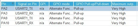

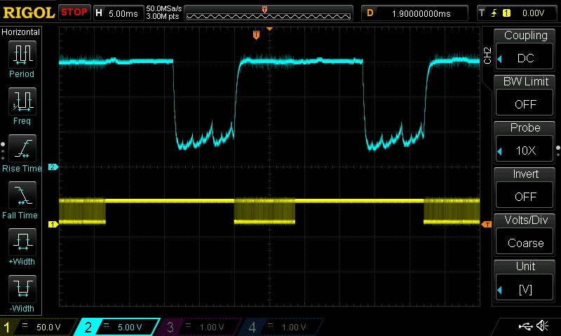

I'm having the same problem on 2 different boards. I gen'd up a simple program using CubeMX and I'm only sending some data to both ports at the same time:

See the document for your board, page 22. https://www.st.com/resource/en/user_manual/dm00039084-discovery-kit-with-stm32f407vg-mcu-stmicroelectronics.pdf
Pins PA9, PA10 are not free to use. They are connected to the green LED and USB.
Before assigning pins, check that these pins are free to use - even if they are routed to connector.
Try USART3 on TX PD8, RX PD9

Show circuit, what you connect to the boards, so its not only guessing...
On your scope pic : 50v/div + 5V/div -> about 30Vss + 15Vss signals , where you measure this ??

I just had the scope probes hooked up to TX of UART1 & 2. I didn't bother to set the voltages.

I think you may be right. In the manual, I found this:
USB LD7: green LED indicates when VBUS is present on CN5 and is connected to PA9
of the STM32F407VGT6
