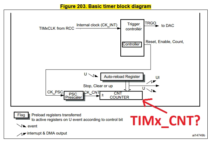

I have one more question:
What exactly is the register TIMx_CNT used for? The reference manual says Counter value, which I understand as the current counter value that increases with every clock cycle (after prescaler etc). If I am correct with that, then what is the reason that the register is both read and WRITE?
Thank you,
Apr 28, 2020 6:06 PM UTC
Your understanding is correct. It's read/write because sometimes you want to change the value, simple as that. Your program doesn't need to, but sometimes it makes sense to start the counter from ARR-1, or from 0, or from the middle. Or if you want to reset the counter to avoid an update event, or whatever.
