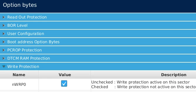

maybe you (your cpu) have some write protection on , check in  STM32CubeProgrammer :
Check: erase is on:
And try full chip erase , if still wrong.

The first option, where I an find? The second option, I using in that way and I can found de error with that option. When I debug the code, it's never call the function MEM_If_Erase_HS so, it can't write the new code because it need all memory erased.

If you do something with write protection, its another question (i assume : Emulated EEPROM is doing something..)
But if you program with CubeProgrammer , you can set/reset flash (as i do also); whats wrong then ?
