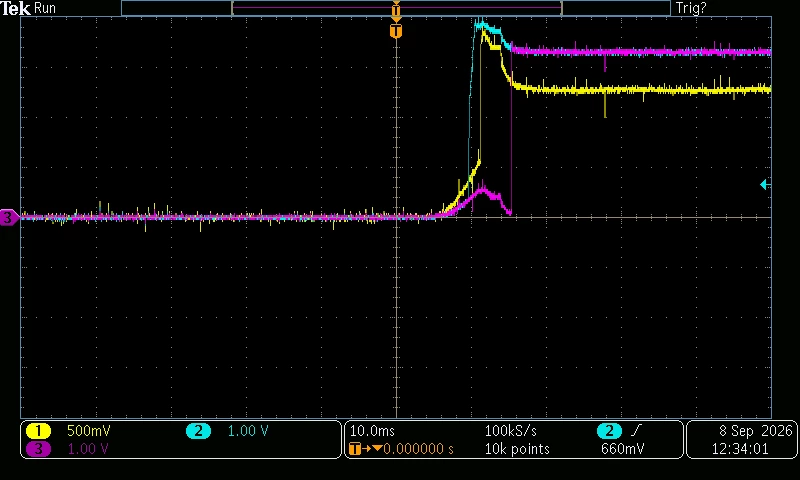

VCAP Overshoot (Uncertain Impact): Probing with an oscilloscope reveals that when the MCU attempts to boot, the 1.2V core voltage (VCAP) sharply overshoots to 2.0V before eventually settling down. VDD (3.3V) remains completely stable during NRST events. We are not entirely sure if this overshoot is a primary cause of the issue or just a secondary effect.
Yellow : +1.2V VCAP
Blue : VCC(+3.3V)
purple : reset

  • Bleeder Resistor Test: We added a parallel bleeder resistor (1kΩ) to the VCAP capacitors to forcibly accelerate the discharge of the core voltage line, hoping it would quickly drain whatever was locking up the MCU. However, despite rapidly discharging the VCAP line, the required delay times (2.9 seconds for reset, 1-2 minutes for power-off) remained completely unchanged. This indicates that discharging the external 1.2V domain does not help resolve the internal lock-up.

We theorize that this trapped high voltage blinds the flash sense amplifiers, causing the garbage vector fetch. We also suspect this charge might be leaking backward to cause the VCAP overshoot, but we are uncertain if the overshoot itself is fatal to the boot sequence.
