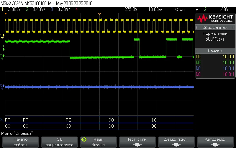

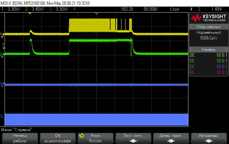

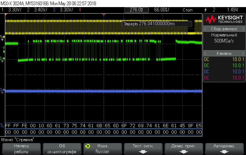

Im trying to catch data from the unknown device, this device has data and clock. I decided to make my stm32 as spi slave and catch the data as recevier.And im struggling with it. I have this data flow which i want to catch:
Clock is yellow and green is data.
I need only 16bytes from it, when data line goes low, we can see this 16bytes:
And there is the speed of the clock, as you can see its around 1.5us each clock pulse. So what i have to do is configure spi with HAL, i toolk SPI1(PA5 - CLOCK, PA7- DATA) cuz it has more powerful MHZ, chose spi mode ''RECEIVE ONLY SLAVE'', HARDWARE NSS SIGNAL: DISABLED. And here is my spi1 config:

i managed to synchronize slave and master with HAL function:
HAL_SPI_TransmitReceive(&hspi1, (uint8_t*)spi_buffer, (uint8_t *)spi_buffer, 16, 2000);
Im sending from slave the bytes which i get from master, in purpose of debugging, and the data is same, so its perfectly synchronized and seems like slave reading all data master sends. Here is the images:
1) Slave is my STM32f4 and master that i catching, its the same
2)Zoomed up
The problem is that i dont know how to read that data, its 16bytes which i need somehow to read without slowing the spi down. All my attempts to do that are failed. The whole code are:
