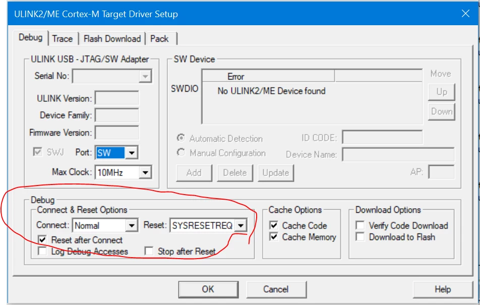

    Hello
    Here is an answer I received from Hans, one of the Keil engineers:
    The TRST signal was never really necessary. It exists on many ARM7/9 and also Cortex-M3/4 devices but it is only available in the old 20 pin JTAG connector. The newer 10 pin Cortex and 20 pin Cortex+ETM connectors do not contain this signal. There are newer devices (especially Cortex-M0) which only have a SWD (no JTAG) interface and they don?t have a TRST signal at all. So one can leave this signal off. This saves one pin.
    uVision uses the methods to RESET the part:  you can select them here:
    A ULINK D is a ULINKpro without ETM instruction trace.  SWV works fine.
