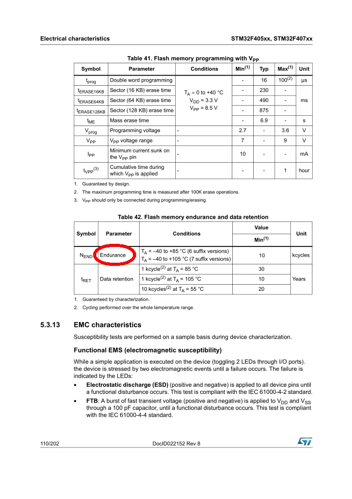

STM32F405VGT7 Flash memory write endurance : how many times can the internal FLASH be written / erased?

Either I checked the wrong datasheets, use the wrong keywords, am blind or the answer is in a source I didn't find or check.
Please help

    waclawek.jan
    August 17, 2018
    Source: STM32F407 datasheet.
    Keyword: endurance.

    oh, Thanks a lot.
    don't know​ how I could miss this when I had it in front of me.
