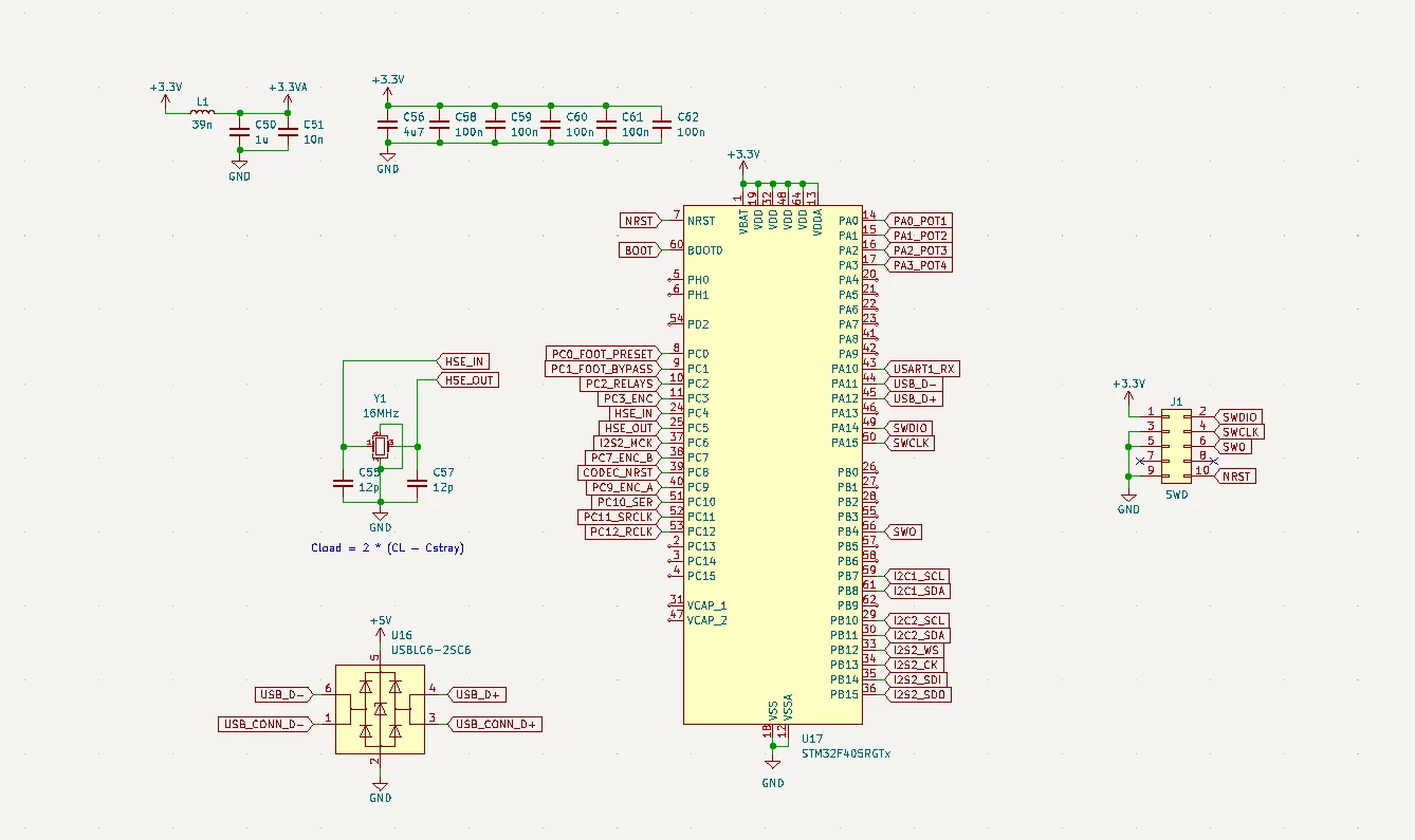

Hi guys, this is my first post here on the forum. I'm starting my learning in STM and I created a custom board with a STM32F405RGT6, I followed a basic MCU operation schematic that I found in a video on Youtube, but the MCU is not starting. I did several tests to check if the USB connection was correct, if the voltages also worked well and everything is ok. However, I saw that I really don't get a clock from the crystal, the crystal I'm using is already known to me from other projects. So I'm leaving here a print of the connection schematic and if anyone can give me some light on where to look for the problem that causes the MCU to not start, I would be very grateful.:grinning_face:

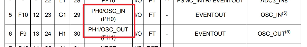

Also, I didn't notice this at first glance:
You're connecting OSC_IN and OSC_OUT to PC4 and PC5 while it should be connected to PH0 and PH1 like provided in the datasheet:
I'm wondering what kind of Youtube link you're referring to!

Hi guy, thanks for your reply. I have already done all the checking on my PCB and the schematic is being fully respected, I am a guitar pedal manufacturer and have a lot of experience with custom boards from other MCUs (Atmel and ESP). Can you see a connection error or a pin that should have a connection and is floating in the image I attached?

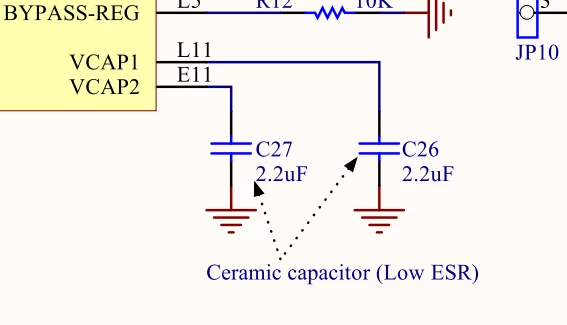

Did you fix the VCAP errors? Going to be hard if you didn't put any traces/pads on those pins. Is the voltage on VCAP ~1.2V?
Once it's set up right, you should be able to open STM32CubeProgrammer and hit connect to connect to the device.

You need to refer to the STM32F4 hardware getting started AN4488 and refer to the schematics.
From your schematics at least VCAPx capacitors are missing:

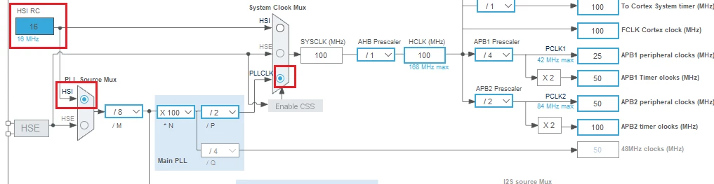

Forget about the crystal for now and try to run with HSI as clock source for system clock:
Do you face the same issue?

I didn't have access to st link v2 and v3. However, I managed to correct the layout errors on my custom PCB. The crystal oscillator was actually on the wrong pins and the lack of VCAPs prevented the STM from starting. I managed to solder these components to the STM pins and everything worked.
