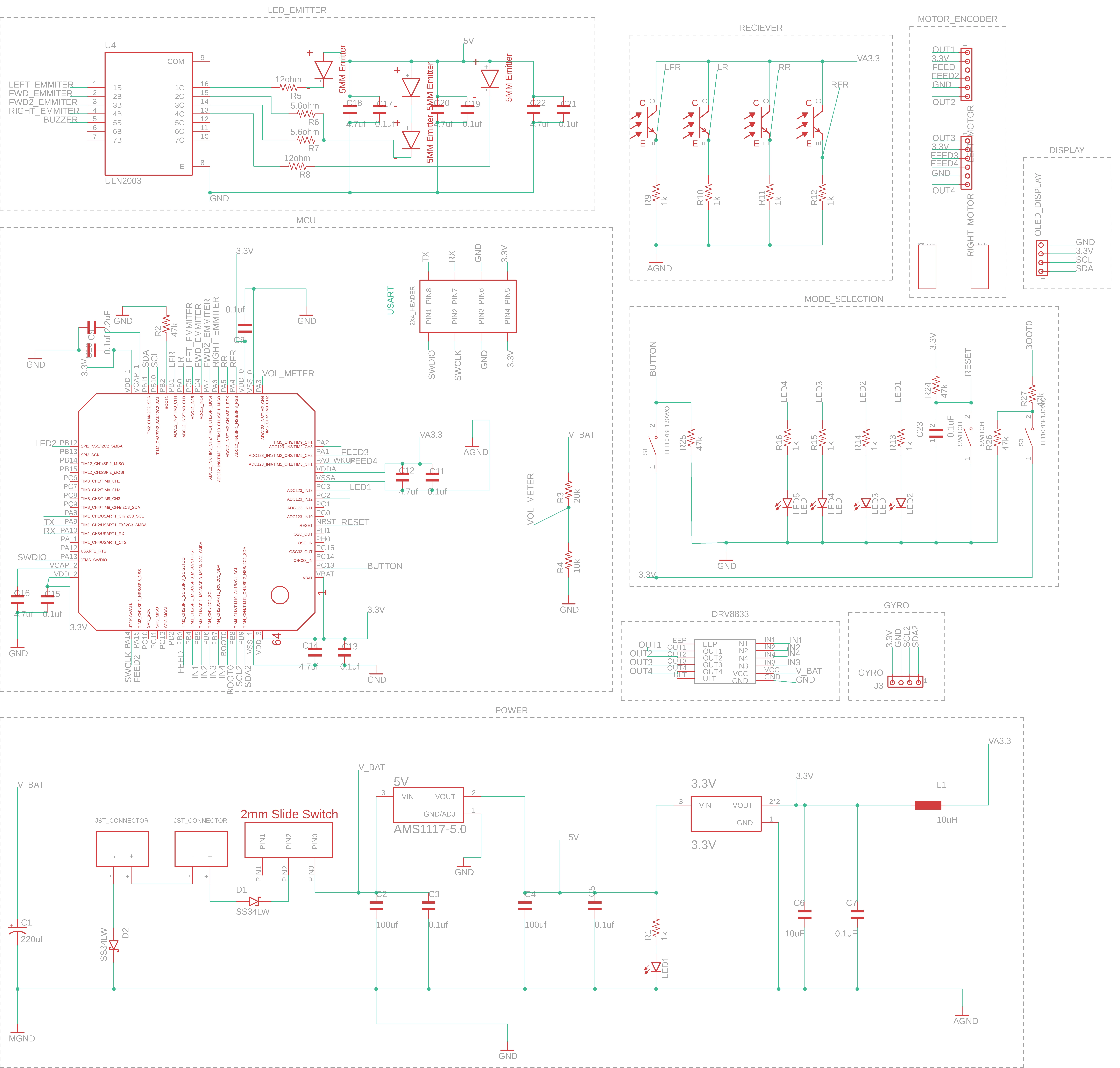

hey, I'm developing a custom stm32f405rgt6 board. I'm using stlink for uploading code. I'm comparitively new to stm as i've only worked with blue pill. I get "Error: No STM32 target found! If your product embeds Debug Authentication, please perform a discovery using Debug Authentication" this issue whenever i try to connect with stlink. i was not able to connect even once. I'm attaching the schematics below. I'm getting please help me solve the issue.

Hi @ArnavTakle ,
if you have a multimeter / ammeter : try to measure the Voltage at VCAP1 and VCAP2 pins close to the 2.2uF and 4.7uF caps - it should be around 1.2 Volts .  Then to check VDDA pin if the self between digital and analog rails is connected . Also if possible to know the power consumption at that inductor ? It seems more a hardware issue and how the STLink is connected to SWD lines and NRST pins .

I'm getting 1.28volts around vcap 1 and 2. i didn't understand the VDDA part. also, i don't know how to check power consumption at inductor. I accedently accepted it as solution.

No Worries  having 1,28V that means the MCU is up and working. May be next to check BOOT0 pin if in ground to boot from Flash .  You can also try ST Link Utility and have a log file - the tool is obsolete but to check if the device is genuine - a Top marking picture is helpful also .

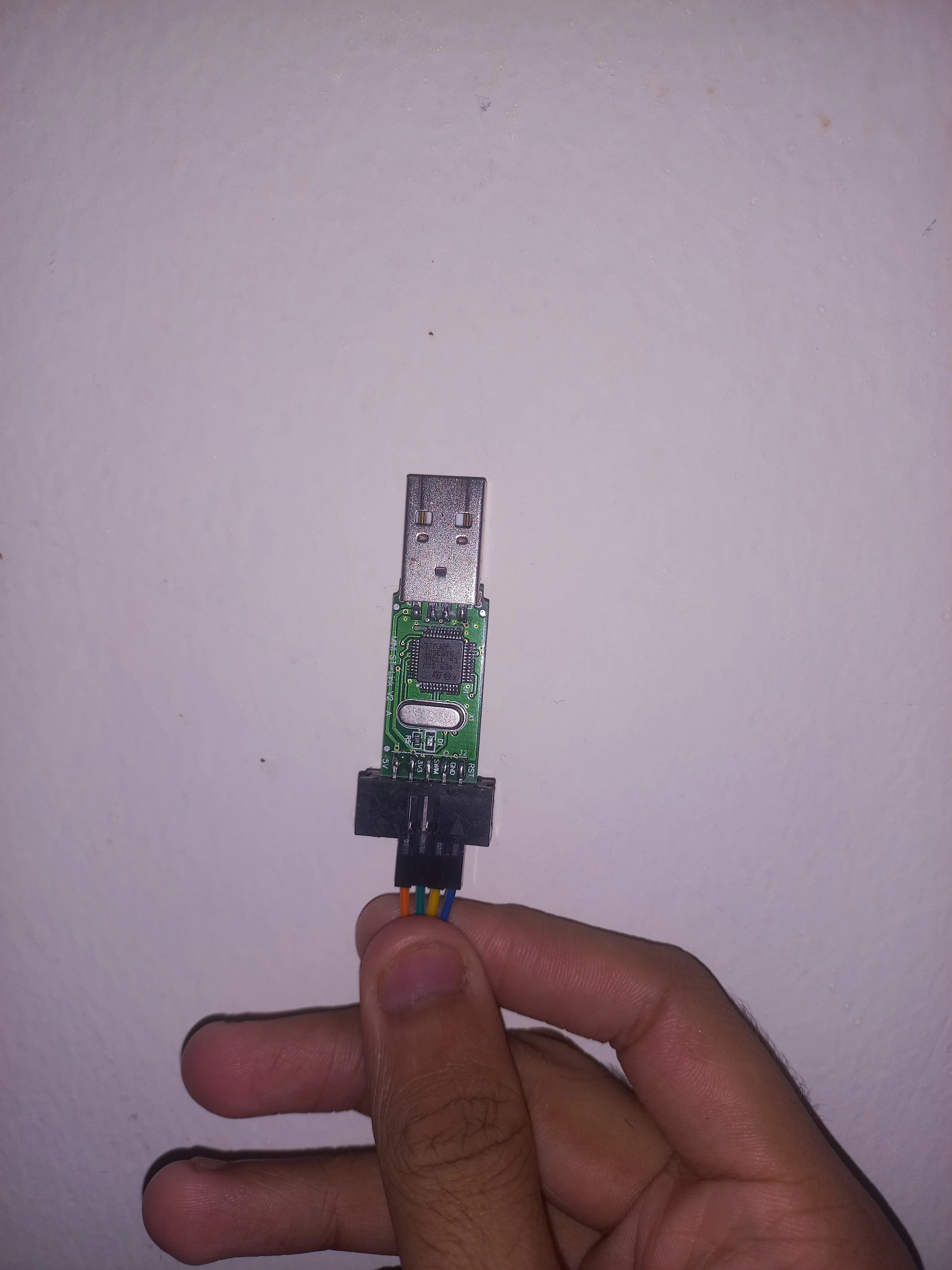

I have ST link V2 mini programmer and it has stm32f103CBT6 ic.
i regularly connect my blue pill using it.

That's a clone / counterfeit ST-LINK, don't expect a lot of support / concern related to fixing issues with that.
The error basically means the connection is non-viable, frequently what you're connecting too and power supplies. Code you put on the device can also impede connectivity, ie reassigning pins, or turning off pins/circuitry require in low-power operation. Assuming you're seeing this on new boards, with blank devices.

You can't buy clones and expect ST to provide support (for them). But they do generally work (at least for programming) for most people.

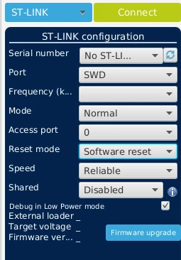

Will the programmer detect stm32 ic while using serial communication?
AScha.3
June 30, 2024
No. (not your clone...)
Need an (any) USB-serial adapter, rx/tx connected to the pins with uart/boot function.
Then connect in Programmer to uart ->
Did you try to connect under "software reset" ? Try. (your clone has no working reset for stm32, usually.)
Usually they do have one. And even without reset, the CubeProgrammer would still be able to connect, it would only be unable to reset after programming. So I don't think reset is the issue in this case.
