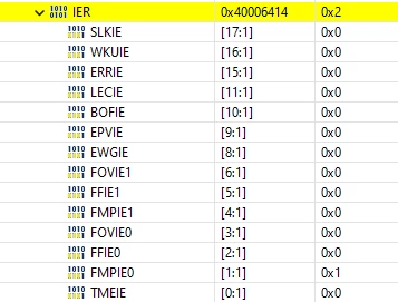

I have been trying to resolve the issue for receiving the CAN interrupt but not able to find the root cause.
Hardware is a custom board micro is STM32F405RGT6 i am using CAN1 for CAN communication with 500 Kbps.
Able to transmit message CAN message using polling method. I am transmitting CAN messages from Peak CAN tool but not able to hit the receive interrupt.

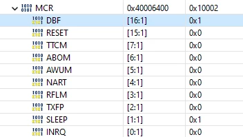

Few observations after reset, the DBF bit is set, will it be a problem?
1.

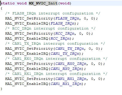

2.I have the Tx interrupt enabled
But the TMEIE bit is not set after calling the MX_NVIC_Init(void)
Coming to the actual problem the FMPIE0 bit is set and i am sending the messages at 1sec interval
FMP0 is always 0. What is the problem?

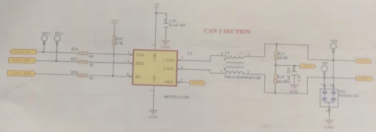

The image is not clear please share another one on which we can at least read the references.
Also for your filter config set a "pass all messages" filter as the following:
canfilterconfig.FilterIdHigh = 0;
canfilterconfig.FilterIdLow = 0;
canfilterconfig.FilterMaskIdHigh = 0;
canfilterconfig.FilterMaskIdLow = 0;

The TMEIE bit is set if i use the function
 if (HAL_CAN_ActivateNotification(&hcan1, CAN_IT_TX_MAILBOX_EMPTY) != HAL_OK)
 Error_Handler();
still the problem of CAN Rx interrupt exists, the isr is not called.

Since it's a custom board, show us the schematic on how the CAN transceiver connection to the F405.
Also have you tried loop back mode?
If a reply has proven helpful, click on Accept as Solution so that it'll show at top of the post.CAN Jammer an open source CAN bus hacking toolCANableV3 Open Source
STUser34Author
May 15, 2024
I have not tried the loop back mode, i will try that as well.
I am not sure if the image is clear i will share the scanned image after some time.

 * @brief NVIC Configuration.
 * @retval None
static void MX_NVIC_Init(void)
 /* FLASH_IRQn interrupt configuration */
 HAL_NVIC_SetPriority(FLASH_IRQn, 0, 0);
 HAL_NVIC_EnableIRQ(FLASH_IRQn);
 /* RCC_IRQn interrupt configuration */
 HAL_NVIC_SetPriority(RCC_IRQn, 0, 0);
 HAL_NVIC_EnableIRQ(RCC_IRQn);
 /* CAN1_RX0_IRQn interrupt configuration */
 HAL_NVIC_SetPriority(CAN1_RX0_IRQn, 0, 0);
 HAL_NVIC_EnableIRQ(CAN1_RX0_IRQn);
 /* CAN1_RX1_IRQn interrupt configuration */
 HAL_NVIC_SetPriority(CAN1_RX1_IRQn, 0, 0);
 HAL_NVIC_EnableIRQ(CAN1_RX1_IRQn);

 hcan1.Instance = CAN1;
 hcan1.Init.Prescaler = 2;
 hcan1.Init.Mode = CAN_MODE_NORMAL;
 hcan1.Init.SyncJumpWidth = CAN_SJW_3TQ;
 hcan1.Init.TimeSeg1 = CAN_BS1_9TQ;
 hcan1.Init.TimeSeg2 = CAN_BS2_6TQ;
 hcan1.Init.TimeTriggeredMode = DISABLE;
 hcan1.Init.AutoBusOff = DISABLE;
 hcan1.Init.AutoWakeUp = DISABLE;
 hcan1.Init.AutoRetransmission = ENABLE;
 hcan1.Init.ReceiveFifoLocked = DISABLE;
 hcan1.Init.TransmitFifoPriority = DISABLE;
 if (HAL_CAN_Init(&hcan1) != HAL_OK)
 Error_Handler();

/* USER CODE BEGIN MX_GPIO_Init_1 */
/* USER CODE END MX_GPIO_Init_1 */
 /* GPIO Ports Clock Enable */
 __HAL_RCC_GPIOH_CLK_ENABLE();
 __HAL_RCC_GPIOC_CLK_ENABLE();
 __HAL_RCC_GPIOA_CLK_ENABLE();
 __HAL_RCC_GPIOB_CLK_ENABLE();
 HAL_GPIO_WritePin(GPIOC, GPIO_PIN_0|GPIO_PIN_3, GPIO_PIN_RESET);
 /*Configure GPIO pin : PC0 */
 GPIO_InitStruct.Pin = GPIO_PIN_0;
 GPIO_InitStruct.Pull = GPIO_PULLDOWN;
 HAL_GPIO_Init(GPIOC, &GPIO_InitStruct);
 /*Configure GPIO pin : PC3 */
 GPIO_InitStruct.Pin = GPIO_PIN_3;
/* USER CODE BEGIN MX_GPIO_Init_2 */
/* USER CODE END MX_GPIO_Init_2 */
