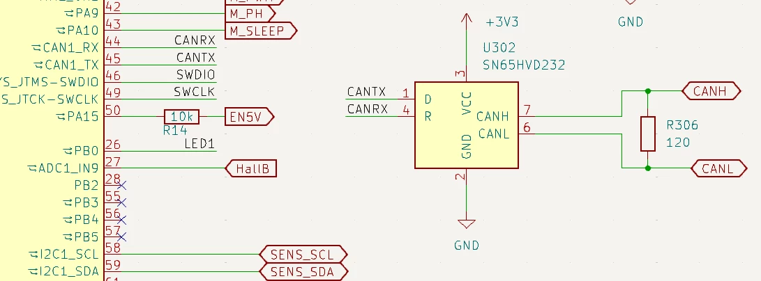

I use the STM32CubeIDE v1.18.0. The boards I use is own hardware with SN65HVD232.

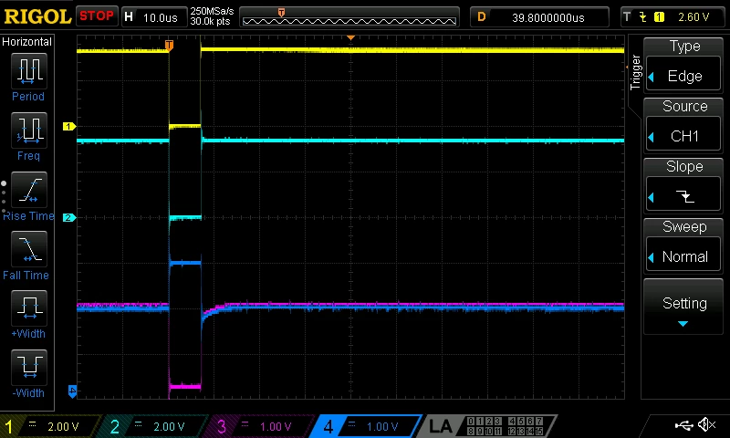

The hardware seems to work well. on the picture you see the screenshot from my oscilloscope, CANTX, CANRX, CANL, CANH after calling:

On a WeAct Module with quartz also not more than this one pulse on the CANTX appear. Where is my fault, what am I not seeing here?
I would expect at least a frame until the ACK.

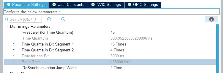

I suggest this timing configuration for a system clock of 42Mhz with 125kb/s a CAN bitrate standard value:
The updated ioc file in attachement.

mƎALLEm
Mar 26, 2025 1:58 PM UTC
Hello @digitalMaik and welcome to the ST community,
I have a question and one remark:
Question: did you connect another node on the CAN bus? if nothing connected on the bus. That's an expected behavior. You need to connect another CAN node to acknowledge the frame.

These are bad timing parameters and most probably the issue comes from these values:
 hcan1.Init.Prescaler = 42;
 hcan1.Init.TimeSeg1 = CAN_BS1_1TQ;
 hcan1.Init.TimeSeg2 = CAN_BS2_1TQ;
 You need to increase BS1 and BS2 as much a possible and decrease the prescaler as much as possible where the sample point is between 75 to 85% of the bit time.
Could you please share your ioc file?

mƎALLEm
mƎALLEmBest answer
Mar 26, 2025 2:18 PM UTC
Thank you for the sharing.
Ozone
Principal
Mar 26, 2025 2:09 PM UTC
As mentioned, CAN requires at least a second node to acknowledge reception.
So, first check if you meet this condition.
Second, each CAN node has internal error counters (TEC and REC). In addition to bus signals (scope), you can monitor those.
And in case of the firmware, I would start with loopback mode, progress to an connection on digital level (CAN Tx and Rx of the nodes connected directly, if levels allow it), and add CAN transceivers only at the last step.
Mar 26, 2025 2:26 PM UTC
Thank you very much.
Now I found it in the RM. Next time I should read the documentation and not only use standard values.
