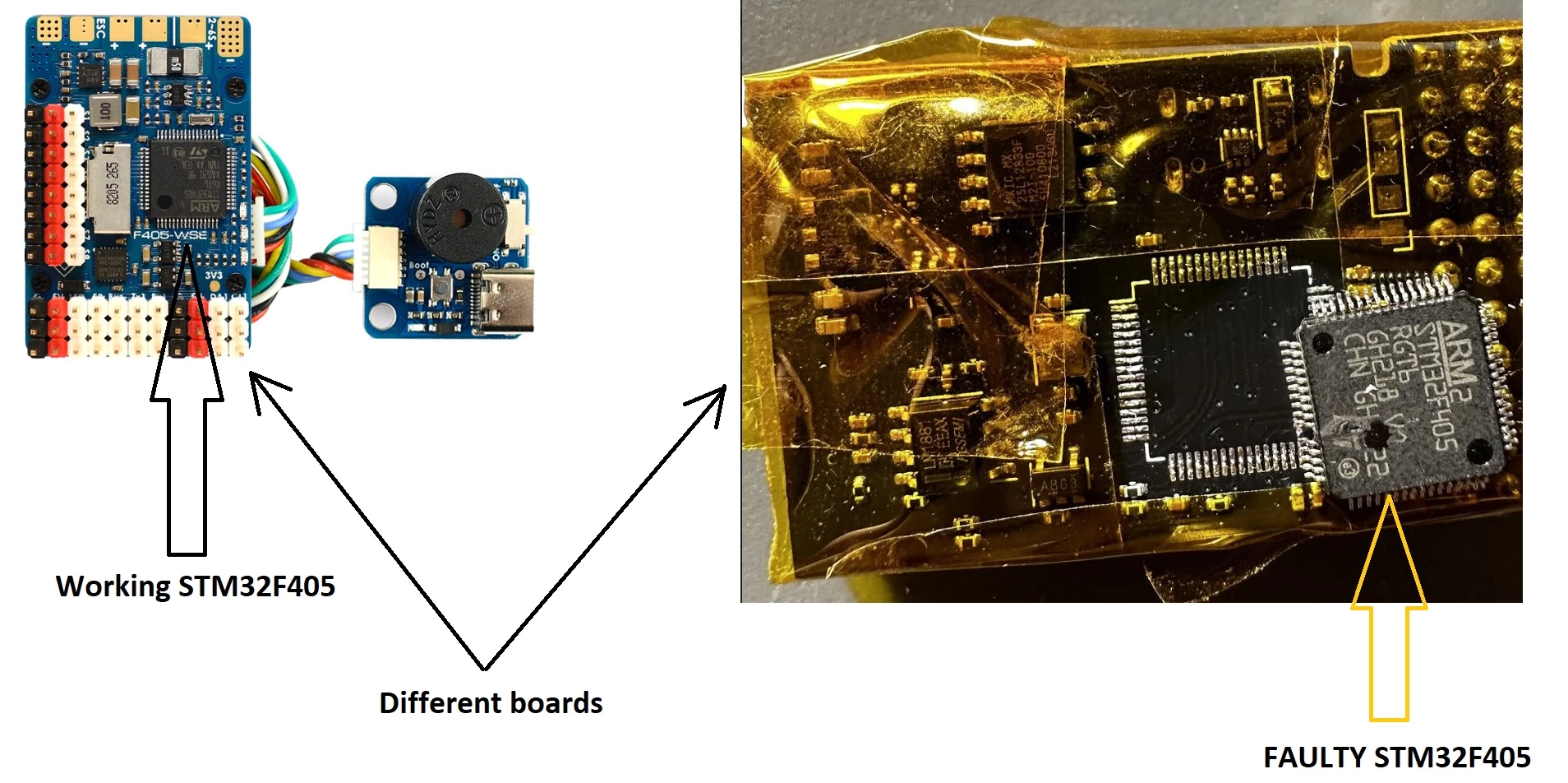

I have a flight controller which has a STM32F405RGT6 MCU and is working 100%.
Another flight controller (different brand) has a damaged STM32F405RGT6 MCU and I would like to swap them instead of buying a new MCU online due to time constraints. Is this possible or it will not work directly?

HF_ATLAuthor
Sep 4, 2023 2:29 PM UTC
Picture attached to make it more clear

Let say Flight Controller A is the one which STM32 is working. Flight Controller B has STM32 faulty.
#A firmware is updated by using a common data USB-C cable to a PC with a provided software.
#B firmware is updated by using a common data USB-C cable to a PC. It opens a removable disk device and the firmware is placed there. After reboot it delete the firmware file.
In both of them you can update the firmware without the need of ST-Link. I don't have any information about the bootloader which is used for the two boards.
I don't have the schematics for the boards. All I know is that there is a USB-C interface for the user to properly upload the firmware and update the flight controller parameters via a dedicated software.

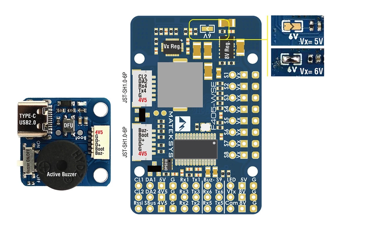

HF_ATLAuthor
Sep 4, 2023 3:50 PM UTC
Also I thought of using the STM32CubeProgrammer in Flight Controller #A to upload the .bin firmware file before desoldering it from the board. This way the MCU will already be programmed after soldering it to the #B.
HF_ATLAuthor
Sep 4, 2023 3:55 PM UTC
Flight Controller #A layout is in attached picture.
Peter BENSCH
Sep 4, 2023 6:14 PM UTC
...and can also be found on his website FLIGHT CONTROLLER F405-WSE together with its manual.
That sounds like a good idea. But if you have an ST-LINK you can also check if the SWD pins of the STM32F405 on board #B are reachable (pin 46 = SWDIO, pin 49 = SWCLK) and connect them together with GND and possibly NRST to the ST-LINK. With this you could also use the STM32CubeProg for programming.
