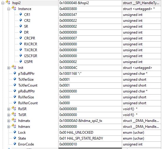

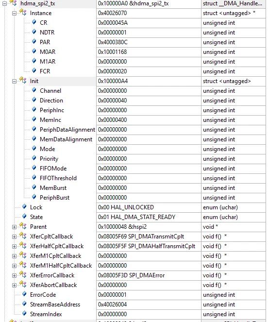

Read out and check/post SPI and relevant DMA registers content.
dimkyy
dimkyyAuthor
August 8, 2021
Hello Jan.
Thanks for looking into my issue.
Here is contents for SPI/DMA registers after trying to sent byte over SPI with DMA:
waclawek.jan
waclawek.janBest answer
August 8, 2021

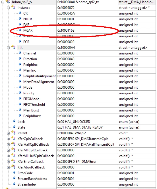

0693W00000D1pjkQAB.pngThat address is in CCMRAM, and in 'F4, DMA does not have access to CCMRAM. Allocate the buffer in SRAM1..3 (i.e. at addresses 0x200xxxxx).

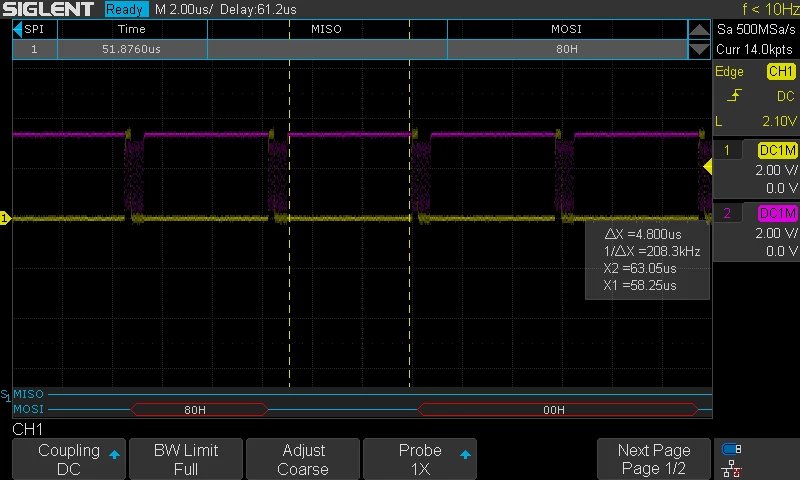

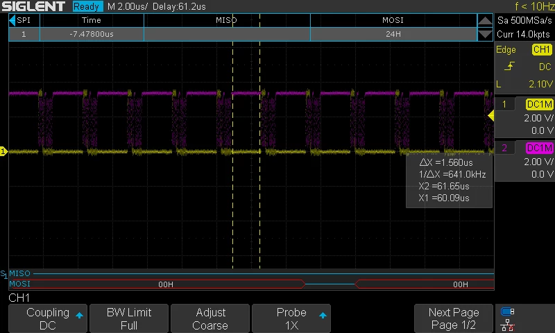

However, another question arises. Why there is so big gap between bytes transmission in DMA mode comparing with basic blocking mode when sending array of data?
Please see attached scope screenshots:
Without DMA:
0693W00000D1pouQAB.pngWith DMA:
0693W00000D1pozQAB.pngBulk data sending function is implemented this way:
static void ST7789_WriteData(uint8_t *buff, size_t buff_size)
	ST7789_DC_Set();
	while (buff_size > 0)
				uint16_t chunk_size = buff_size > 65535 ? 65535 : buff_size;
				HAL_SPI_Transmit(&ST7789_SPI_PORT, buff, chunk_size, HAL_MAX_DELAY);
				//HAL_SPI_Transmit_DMA(&ST7789_SPI_PORT, buff, chunk_size);
				while(HAL_SPI_GetState(&hspi2) != HAL_SPI_STATE_READY);
				buff += chunk_size;
				buff_size -= chunk_size;
dimkyy
dimkyyAuthor
August 8, 2021
Please ignore last post, reason of the delay is due to bytes were sent in separate TX_DMA requests in another function.
Thanks Jan!
