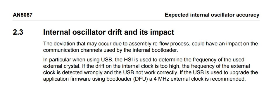

It is indeed a strange behavior.  can you try this
How to optimize STM32 MCUs internal RC oscillator accuracy

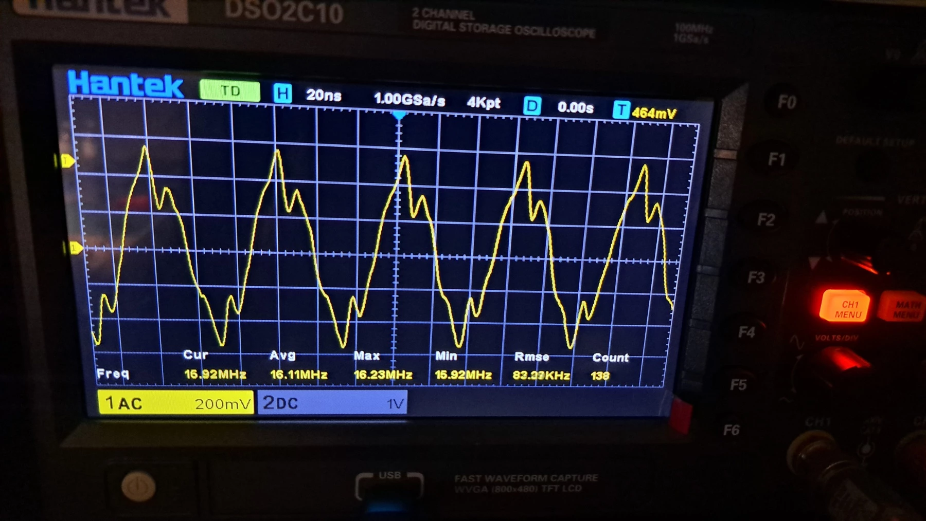

Try to connect via SWD/JTAG and program a simple program , then measure the HSI frequency that should be at 16MHz - you can output on MCO pin and send us the waveforms.

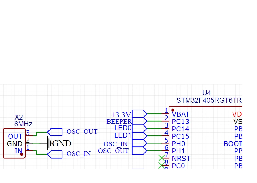

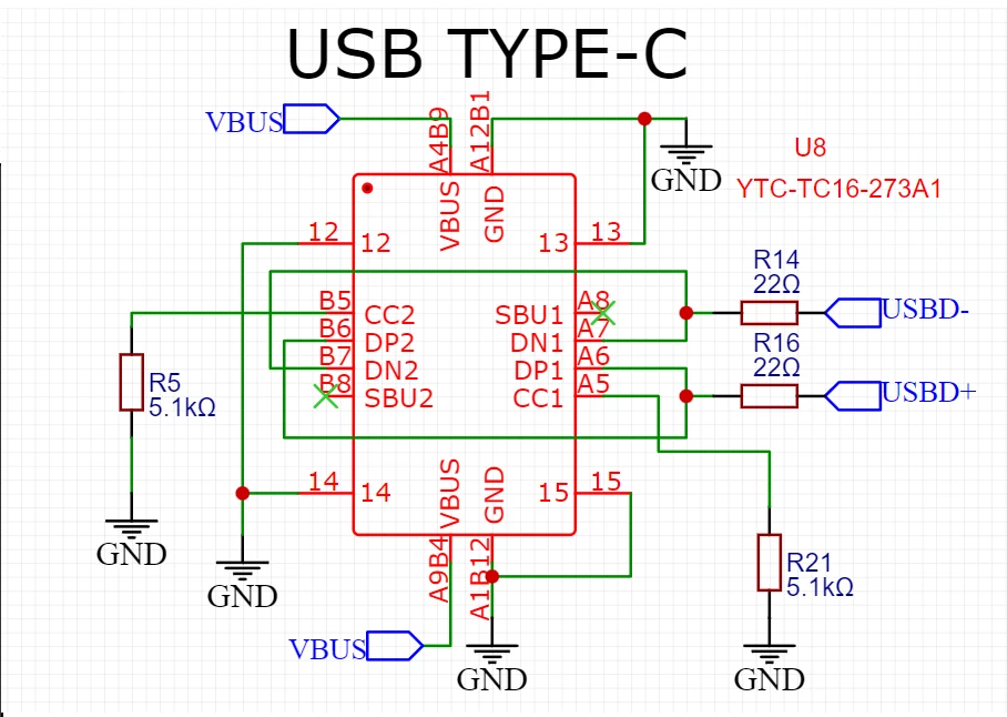

Dear @Taras_Burko ,
Here are my thoughts :
1) remove the two 22 Ohm serial resistances R14 and R16 and replace by a 0Ohm .
2) Can you show the HSE Crystal and reference . Try to put a crystal with 8MHz or 4MHz on the failing parts and let us know if it improve the behavior .
Hope it helps you .
STOne-32
Oct 18, 2024 6:45 AM UTC

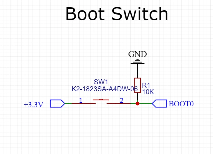

I replaced the resistors with 0 ohms. HSE Crystal stands at 8 mhz.Nothing has changed. The microcontroller refuses to enter DFU.
You need to try to connect the USB cable 10-30 times, and then you can enter DFU mode. If I go into DFU and download the firmware the microcontroller works fine and always connects to the PC via USB and runs the PC program. But does not want to enter DFU mode using the button. I checked the button, it works fine. That is, there is a problem of entering DFU mode using the button.

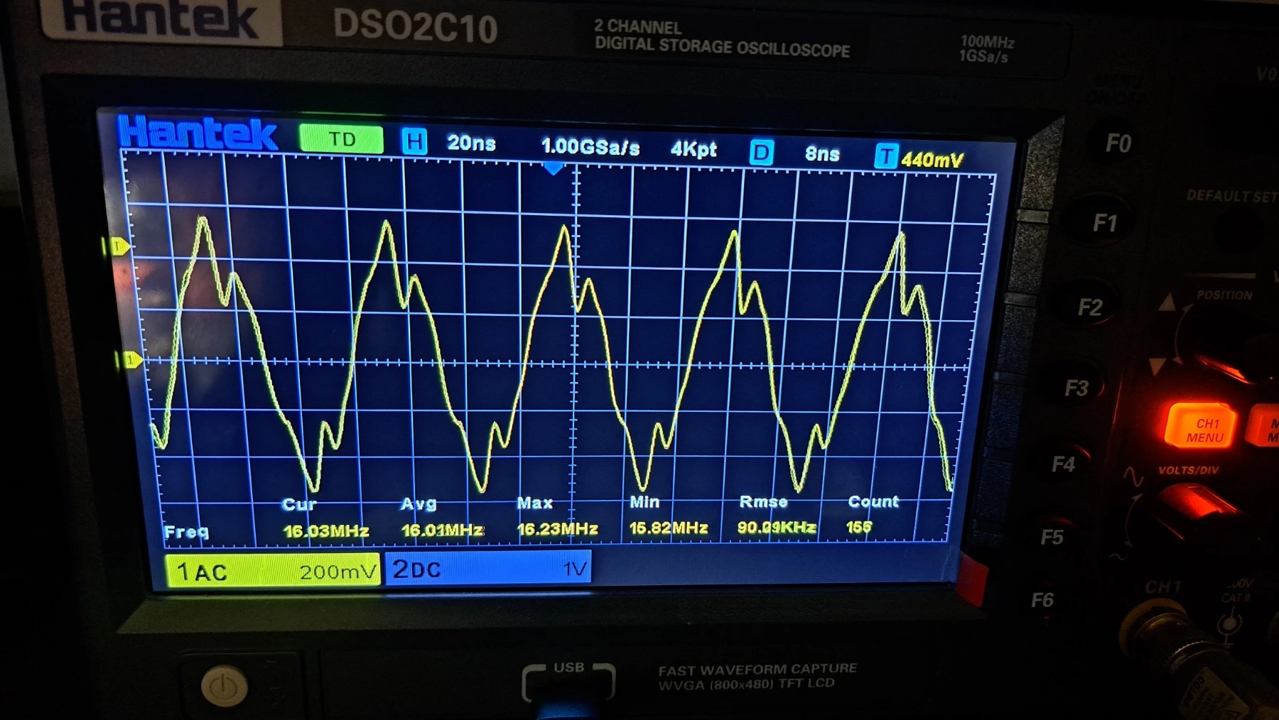

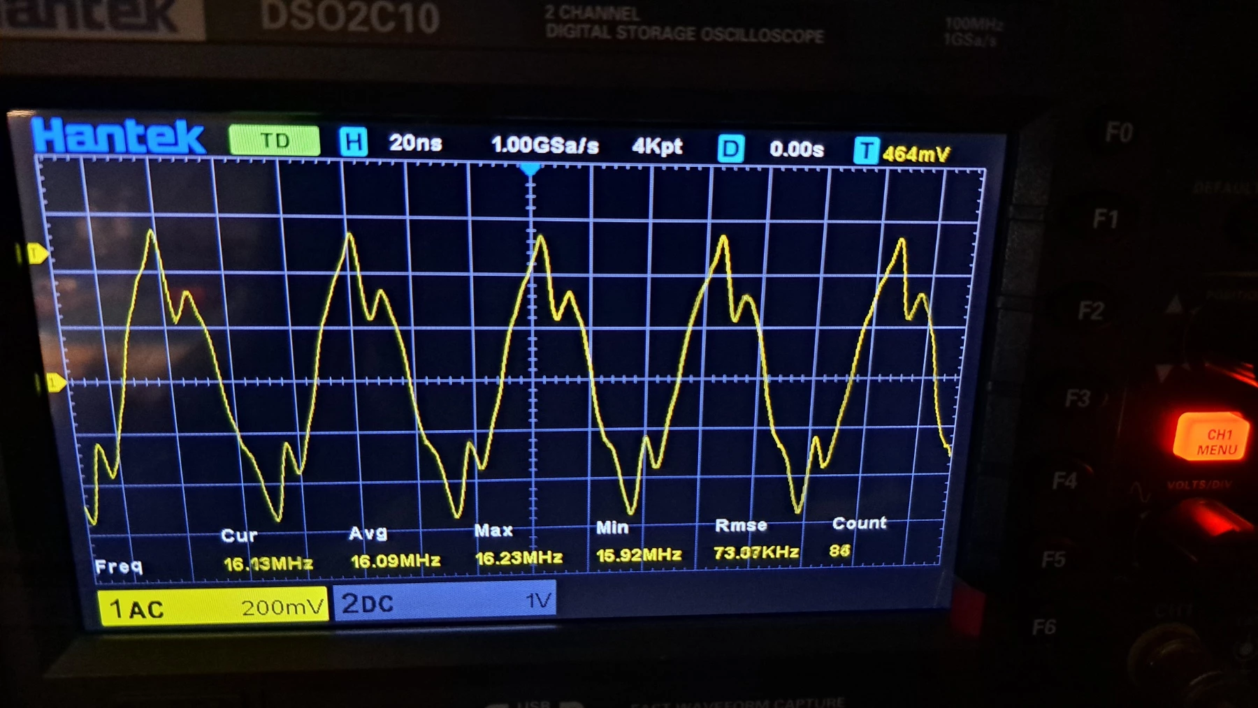

Pavel A.
Oct 18, 2024 5:12 PM UTC
Now please send pictures from good boards.

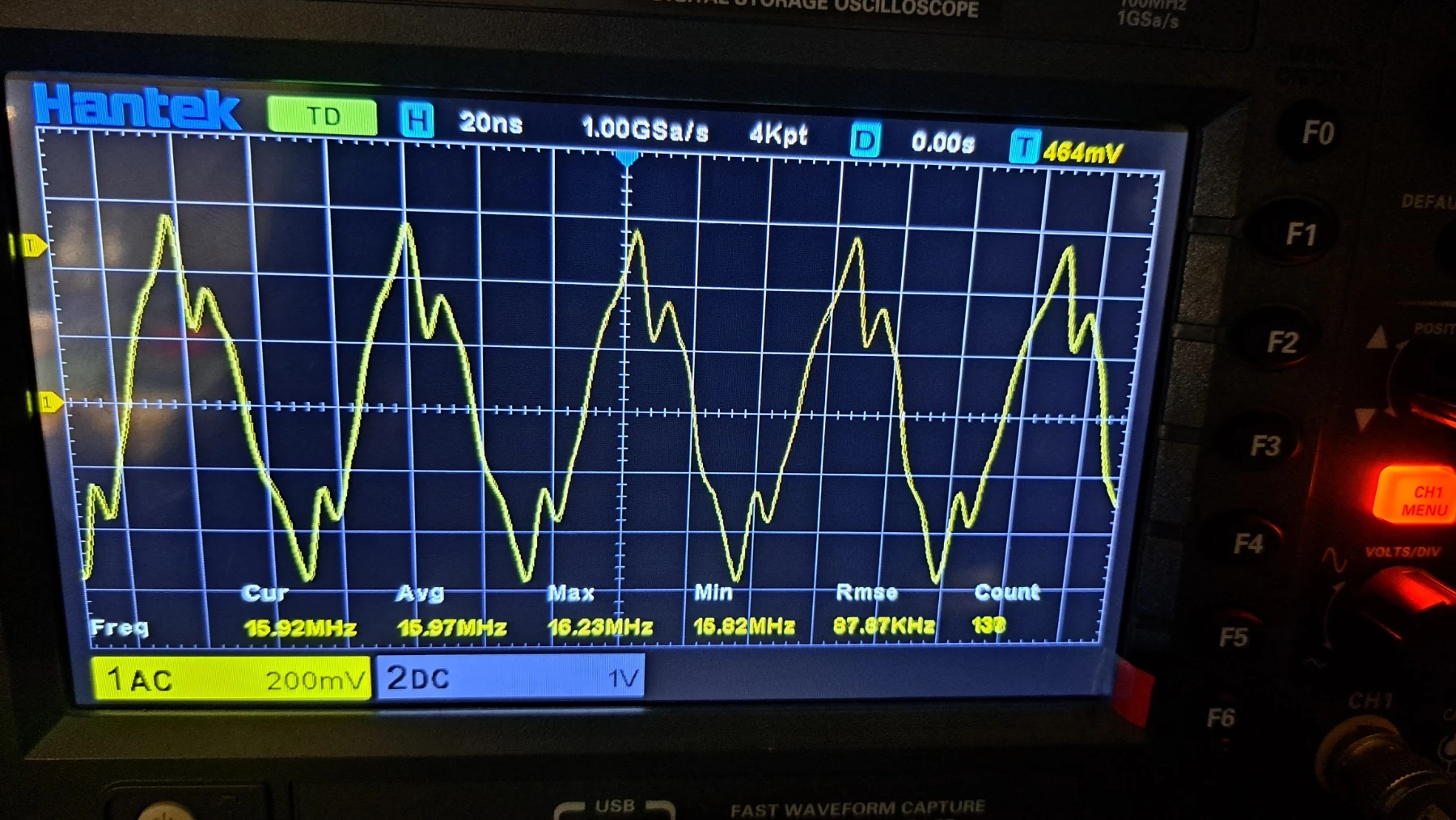

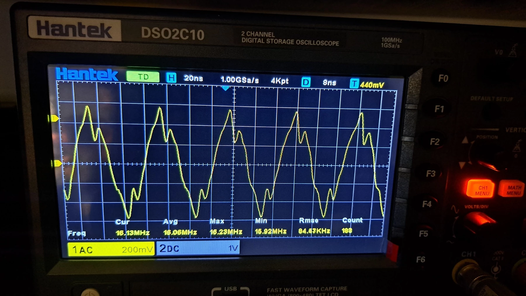

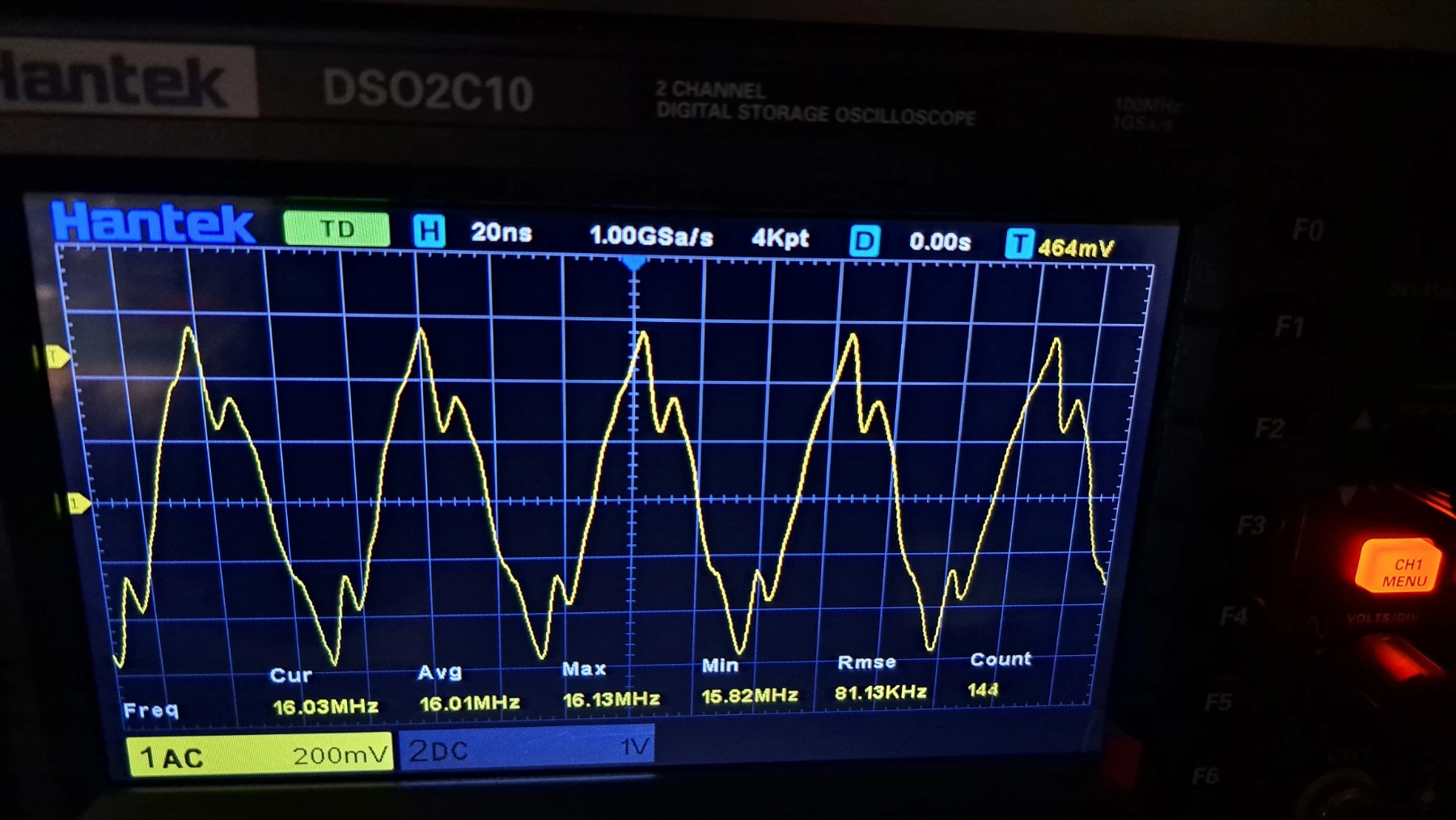

Oct 18, 2024 5:46 PM UTC
Here is the frequency
prototypes that go into DFU.
