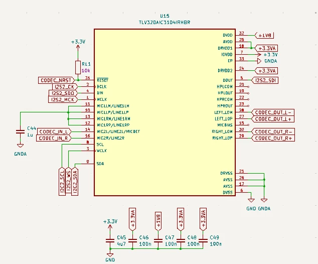

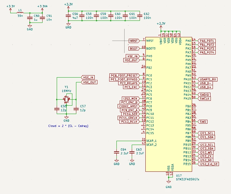

Hi, I am unable to communicate via i2c with the TLV320AIC3104IRHBR chip, the bus response is always busy. I'm just using the STM's internal pullup, I check it on the oscilloscope and the pins are high but no communication happens. Below is my i2c configuration and my schematic.

Schematic stm:
Schematic codec:
Attached I left the codec driver file, you can see what happens when the chip starts
