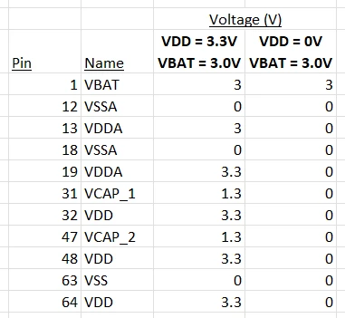

@waclawek.jan - All the power pins are connected, the following table shows voltages measured on MCU pins with w/ and w/o VDD active.  All VSS pins are verified connected to GND w/ an ohmmeter.  There's no PDR_ON pin on this package (LQFP64).  I don't think soldering is the issue, multiple boards that were professionally assembled behave the same.
On boot (breakpoint at the top of main) the PWR_CSR register shows the backup regulator is enabled as expected,
After configuring the backup SRAM, PWR_CSR now shows the backup regulator is ready,

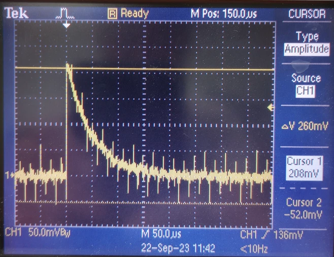

@ONadr.1 - I measure no current into VBAT when VDD is off, but that may just be that the current is too low and in the noise floor of my 1 V/A current monitor.  I'll work on setting up a uA-range current measurement.
There's a current spike into VBAT when VBAT is off, but connected to a PSU, and VDD is applied (no current spike if not connected to PSU).  I don't see any current on VBAT if it's on when VDD is applied.  Peak is 260 mV, which equates to 26 mA (1 V/A + 10x turns of wire around probe).  I don't know what, if anything, can be inferred from this.

Pins 18/19 are VSS/VDD pair, but nonetheless:
[Can't upload image due to Khoros/ST limiting number of images I can upload... Sigh.]
STM32F405/407 datasheet, Power supply schemes chapter: VDDA and VSSA must be connected to VDD and VSS , respectively.
Power supply scheme, footnote: VDDA = VSSA.
Absolute maximum ratings, Variations between different VDD power pins, max. 50mV.
The 0.3V difference in your case is probably not detrimental to actual operation when VDD/VDDA are up, but, the current spike you've described above... have you read the story I've linked to? As reset circuitry which also switches over from VBAT to VDD for the backup-power domain is controlled from VDDA, if VDDA rises later than VDD, the whole mcu is powered from VBAT during that moment.
September 22, 2023
Correct - pins 18/19 are VSS/VDD, not VSSA/VDDA as shown in the table (dang excel autocomplete).
Funny how often these questions can be answered by reading the datasheet...  Thanks for pointing me to the right spot in it!  And the link you sent reinforces that this is probably a VDDA != VDD issue.
Section 2.2.14, p. 24 - VDDA and VSSA must be connected to VDD and VSS
Section 5.2, p. 78 - Variations between different VDDx power pins < 50 mV
That looks like my problem.  I'm powering VDDA at 3.0V and VDD at 3.3V.  I guess I need to make due with filtering 3.3V rather than using a precision 3.0V reference.
