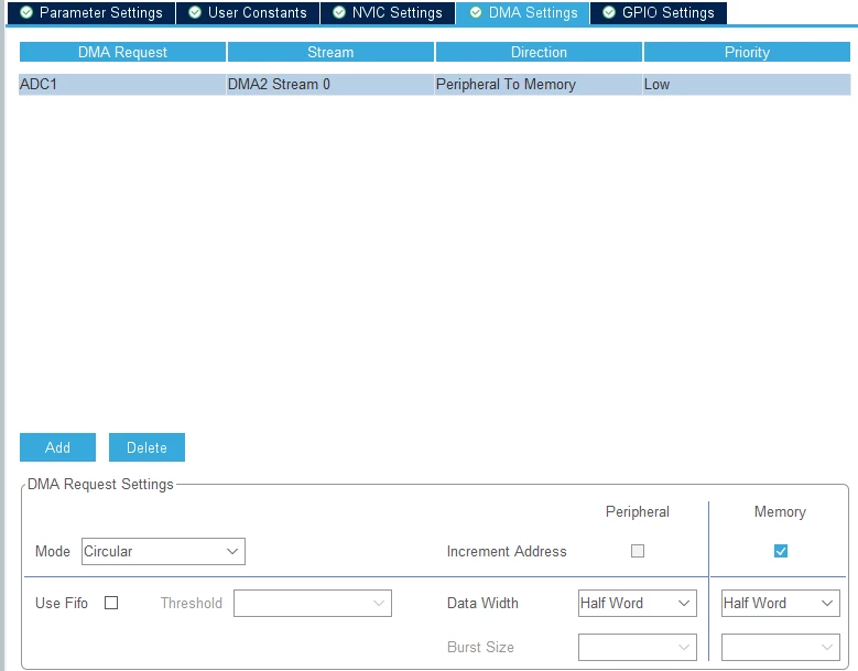

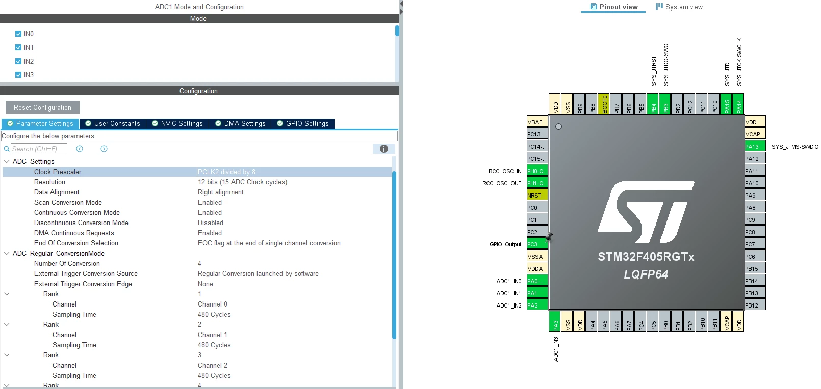

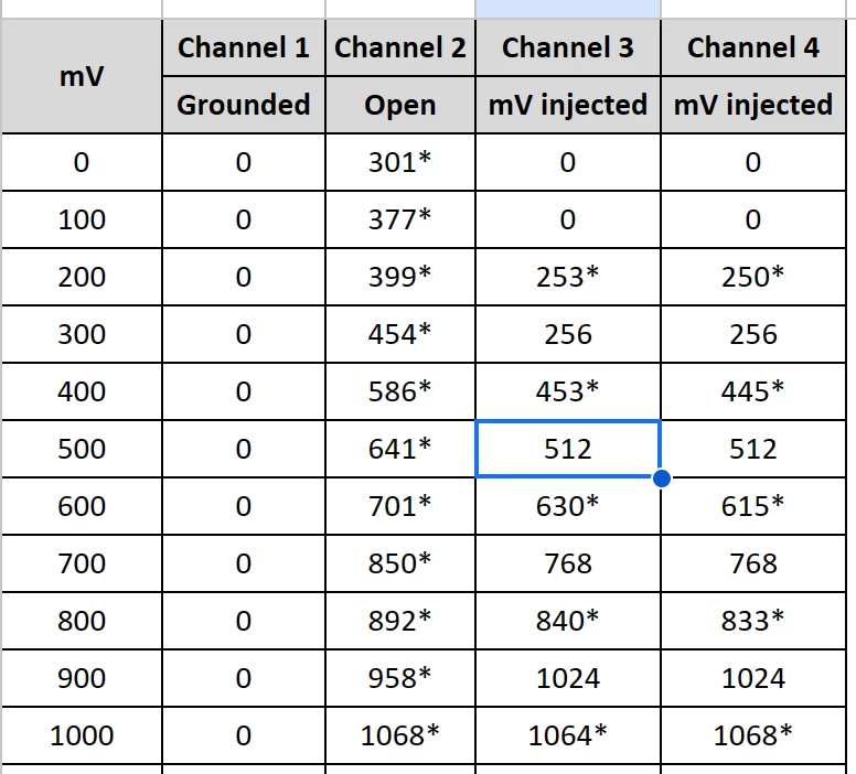

I'm using the STM32F405RGT6 to continuously read 4 ADC channels with 12-bit resolution. The problem is that the results the ADC is giving seemed non-linear, as you can see in the Excel file attached, where I tested it by injecting voltage from a signal generator directly into the ADC pins.
The ADC configuration I'm using is as below:

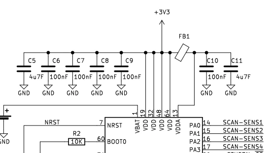

The voltage reference in the MCU is as below:
Any thoughts on how can I fix this problem?

I'm not sure how to interpret the data exactly. What does the asterisk mean? Seems like there a jump every 200mV, but every other increment has no jump. Sort of.

Schematic looks fine.

The asterisk means that the value is not stable and I had to put the mean value.
