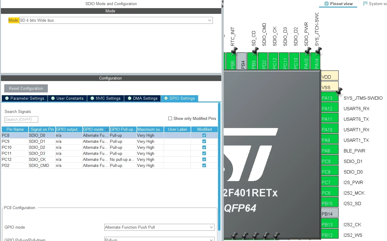

Hello Everyone
I am using FATFS on STM32F401RE, with the code generated by CubeMX, which is version 6.12.0. When I perform the mount operation, the return value is FR_NOT_READY. However, initializing the SD card through the HAL library and reading SD card information using the HAL library are both normal operations. Therefore, the SD card is functioning correctly, and the circuitry between the SD card and STM32F401RE is also normal. So, how can I resolve the issue of not being able to mount the file system?
AND this is sdio config

Since the HAL library can communicate with the SD card normally, I have compared the code involved in the HAL library initialization and the f_mount part, but there seems to be no direction for a solution at the moment. Because using the HAL alone without FATFS can correctly read the SD card information, the only thing that can be confirmed is that the SD card and its circuitry are normal. The problem seems to be with the FatFs configuration, and the issue is still being resolved.......

It could be something related to the bit mode: 1-bit / 4 bit.
See this thread: https://community.st.com/t5/stm32cubemx-mcus/solution-for-stm32-f7-sdmmc-in-4-bit-wide-bus-mode-issue/td-p/618418
TonyMayAuthor
November 19, 2024
Hello, I have tried using SD 1-bit mode and SD 4-bit bus mode, but the problem persists
mƎALLEm
Technical Moderator
November 19, 2024
Check your HW (pull up resistors etc ..), your SD card, your wiring ..
